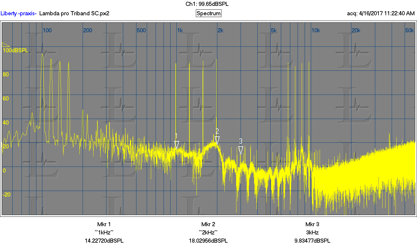

Back to distortion measurements of microphones. This is in effect a measurement of microphone distortion. Its a Lambda pro headphone on a custom test fixture (flat 3/4" plex plate) with a "toy" Panasonic wm-61 microphone. Its a spectral contamination plot at approx 100 dBSPL with three groups of tones in three bands selected so no harmonic or IM product will overlap a tone.
This is a high res FFT which is why there is good resolution into the noise.
You can see on the middle set the harmonics are approx 70 dB down. The IM products on the HF are around 60 dB down. Worst case is the LF harmonics at around 40 dB down.
1) The Lambda pro is a very low distortion source
2) The Panasonic microphone seems to keep up just fine.
3) LF distortion is a more difficult problem than HF distortion.
4) ?? does the diaphragm of a microphone need to move more for low frequencies like a speaker?? Could that relate to the LF distortion?

I think the topic now was to measure microphone distortion. The method I used measures at about 100dB SPL and it shows both IM and HD distortion is 0.02 - 0.03%. This is the only relevant output, to me, I know that for SPL <=100dB I do not need to bother with microphone distortion when measuring in a listening position. I do not have more than 100dB SPL at my listening place when I listen to the music. All else is irrelevant, IMO.

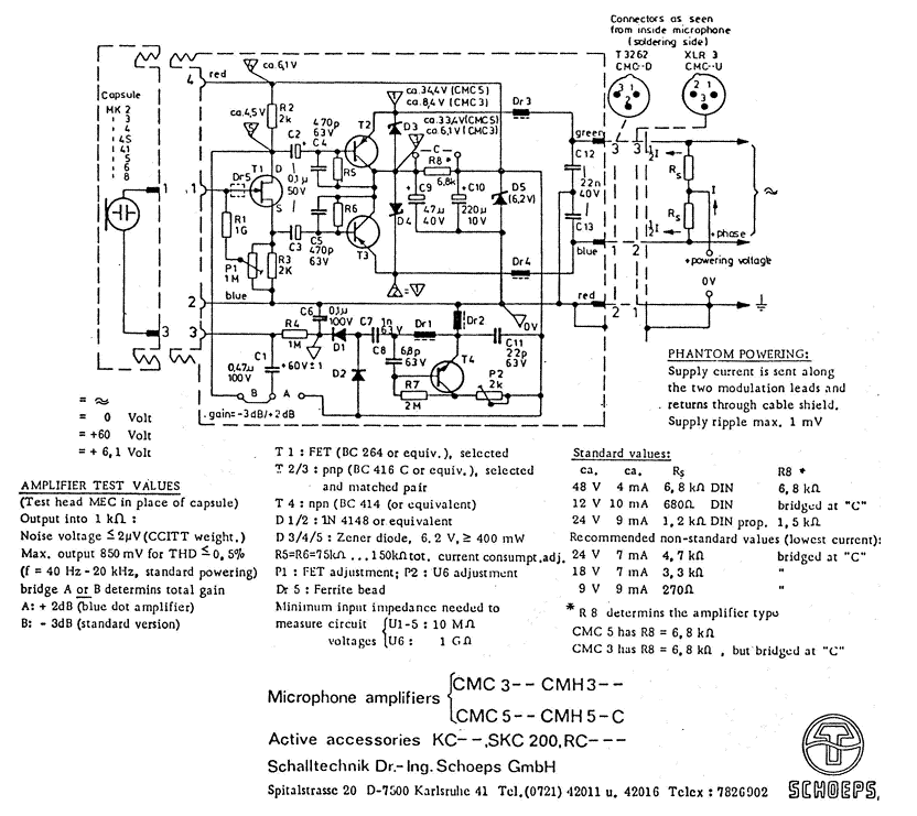

The microphone is quite a usual 1" condenser type, with K67 large 34mm capsule and Schoeps interface circuit. I am not sure if every piece has the same distortion parameters so I am not giving the type. No distortion cancellation method has been used.
In the german thesis Jakob linked to a few pages back (post 12490 iirc) it was found that neither the diaphragm nor the electric circuit (when properly done) are major distortion contributers in measurement mics (1/2" class, onmi). The air cavities, both directly behind the membrane and the larger one behind the perforated back-plate have been found to have the strongest influence, not what the author expected. Smaller is better wrt distortion (distortion goes with volume squared).1) The Lambda pro is a very low distortion source

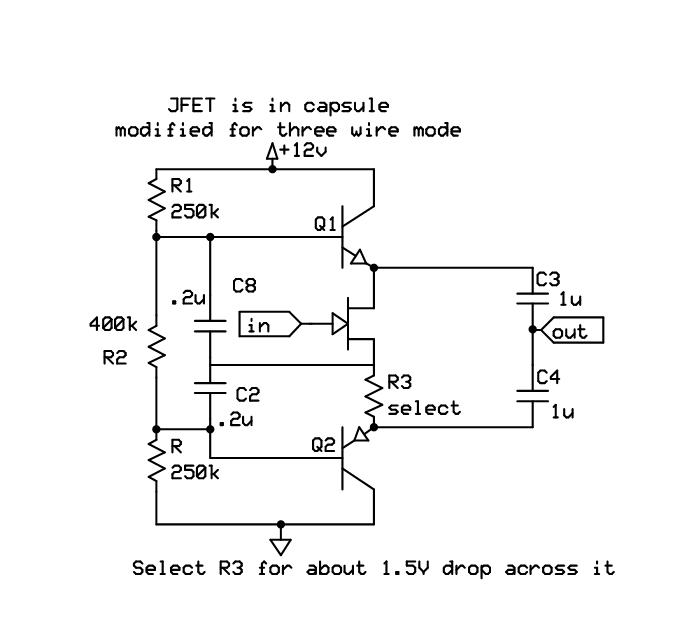

Don't get the ones with the built in FET if you want to build the Schoeps type circuit. Follow the original circuit (the trim is required to cancel 2nd's) using a small low Cgd FET like a 2SK118. Try to use a 5G rather than 1G bias resistor too. There is a picture of the null working in my LA article electrically measured you can get almost -90dB, the acoustic null would depend on the phase of the seconds from the capsule.
If you have a capsule with built-in FET the simple circuit on the right works remarkably well. You can use any high beta lowish noise bipolars like from the BC series and there are some howto's on the web for doing the Linkwitz mod without destroying a few capsules (Transsound might have some 3 wire versions). If you missed my warning their schematics are misleading and you can't always tell if there is a FET or not.
EDIT - Not shown is the third wire (case) it is grounded.

As for the capsules, I took TSB-140AO (3-terminal) and TS-60A (two-terminal but easy to mod), both seem to have JFETs built in. Thanks for the circuits, especially that of yours on the right with the clever bootstrapping BJTs doubling up as buffers, I'll definitely give it a try (have tons of hfe-matched and noise-tested BC550's and 560's).

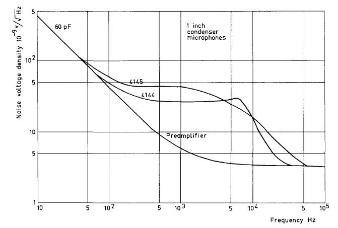

I have a few TSB165a's which are quite popular with DIY'ers in the Schoeps circuit. You can tape two face to face and couple the front chambers together and observe the Brownian noise without any room noise incursion.
Keith Johnson suggested to me putting the microphones in a vacuum to see the real noise floor. No air to excite the diaphragms.
