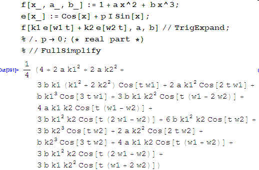

A couple of technical points that seem to be sometimes lost here. First, both loudspeaker drivers and microphones operate in a Class A mode. That means that there should not be any random nonlinear distortion, and at the lowest operating levels they should approximate perfect. The devices' departure from this, both the speaker and the microphone should be predictable over a considerable range of amplitude from just one good measurement at a specific level. Therefore, if you measure 1% harmonic, or IM distortion at a specific level, and can break up the distortion sum into its components, (best done with harmonic distortion for simplicity) then you can closely predict the distortion components at both higher and at lower SPL levels with reasonable accuracy. The rule however is that 2'nd harmonic will track exactly with level, but 3'rd harmonic will rise as the square of the level. Higher harmonics have an even steeper slope, but normally we can discard them for this measurement. IM is much more complex, and hard to read. Multi-tone IM with 3 or more frequencies is even more difficult, but will give an added 'triple beat' distortion that is twice the level as any of the other two tone components. Even more than 3 frequencies may be interesting, but it will not necessarily reveal any more information in an open loop (speaker driver) or microphone system as we normally find it designed. What I mean here is that a simple jfet follower, the usual main component of a measurement microphone system, has a very predictable distortion pattern that follows the rules of class A operation. More complex circuits COULD have problems, so some studio mikes might deviate from easy prediction. Really cheap mikes usually have really cheap electronics, with very low voltages to power them. They WILL have potential problems, and that is what PMA appears to have run in to. However a B&K measurement mike capsule used with a separate microphone preamp, should have almost no significant distortion at normal working levels of 100dB or so, and even predictably less at lower levels, and this should be enough for the speaker measurements that we are looking for.

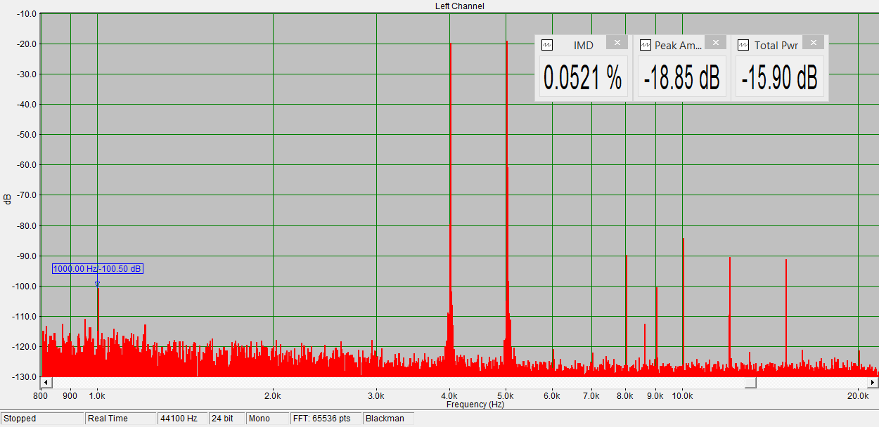

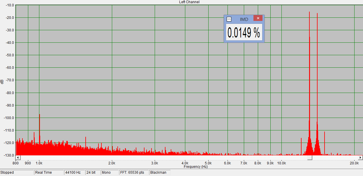

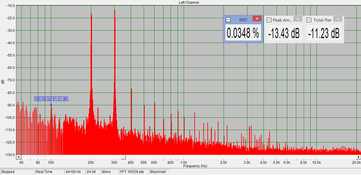

More on two-source method of measurement of microphone distortion. Results for 200+300Hz, 4+5kHz and 13+14kHz are shown. We can see that the difference tone is always 80dB or more below the test tone, even for 200+300Hz test. The plots are messed up with speaker distortion above the test tone frequencies, as expected. I think that -80dB distortion is enough for comparison of distortion under voltage, current or JN drive.
One can also see that i the 4+5kHz test, tweeter distortion is below 0.1% ....

It is fairly easy Richard, once recognized. Yes they teach it in class as well, but if you know the harmonic that is absolutely dominant, then you can predict lower levels with reasonable accuracy. For example, if you had 3% 2nd harmonic distortion at 130dB SPL, then at 110 dB you should have 0.3%. However if the distortion was predominantly 3rd harmonic at 3%, at 130dB SPL then you would have only 0.03% 3rd harmonic at 110dB, BUT then second harmonic might be dominant and effect the measurement, because second harmonic does not drop as fast as 3'rd, but it is just as predictable. One possible problem with instruments with passive meters attached is that the DIODES driving the meter might effect the distortion measurement. I might guess that Demian is finding that a problem. Oh, by the way Demian, any luck finding those other mike preamps?

Anyway, the dependence of the various components on the levels of the sinusoids is clear.
