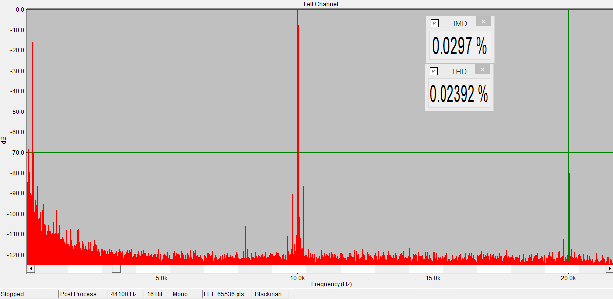

I do not intend to generalize, I can only say that in my case the studio 1" condenser microphone has much lower distortion than the ECM8000 (which is a cheap and entry level measuring microphone) and this 1" microphone has very low distortion in absolute terms. It is a transformerless microphone with Schoeps-like el. circuit (2SK170, balanced output). It seems that any microphone should be tested if used for measuring distortion and that the 2-source IM test might be valuable.
Unlikely, the lowest noise 1" mic readily available (Rode NT1a) uses a (selected?) ordinary SOT23 FET, the substitution with a 2SK170 would increase the noise and distortion due to the input capacitance.
I have some results. It seems that using the two separate speakers nicely gives the distortion of the mic alone and as expected is purely AM but around -73dB ,is this good enough? I do't think the fancy maths brings anything to the party, you could have culled this from a simple high resolution FFT. They might help when there is FM from both tones on one speaker, the displacement on the mic's diaphragm is just too small.
Another comment on distortion, all mics based on electret capsules with built in FET's are biased by the balance of leakages on the input junctions i.e. there are back to back diodes on the input. The Linkwitz mod helps but they are not something you would use for this. I published a circuit in Linear Audio to bootstrap out the input capacitance, but these capsules are still probably too noisy for this application.
Thank you, do you read the AM components as sidebands 10kHz-F1, 10kHz+F2 related to F1 amplitude? This I am able to do, of course, it can be seen from the posted spectrum.
Yes, I remain a little curious about the difference in height of the sidebands (maybe it just falls out of the math I can't remember right now) because it is still there when I use exact 1Hz bins. I grab 20sec of your data and take a 882000 point FFT where the 10kHz tone is better than 1ppm on exact frequency.
I am not sure why is that. Of course I made a FR measurement in the same, 2-source setup (which is not optimal, there is a dip between 1kHz-3kHz due to mike position and phase cancellation), but it did not give an answer. According the FR, their height effect should be opposite 🙂.

If -73 dBr is good enough? Depends on the level uses for the measurements.
At around 90 dB (SPL) it wouldn´t be good enough for really good electrostats for example.

We get some 0.02 - 0.03% IM distortion or HD distortion at 200Hz and even 10kHz from the whole chain, DAC - preamp - power amp - speaker - microphone - microphone preamp - ADC. 1 ppm at 10kHz frequency. This is not bad.
The push-pull idea is good, I wonder if there is a way to use a dual diaphragm capsule of this. BTW I looked more closely and the distortion was closer to around -77dB in PMA's test. It should be OK for the woofer low frequency distortion measurement.
