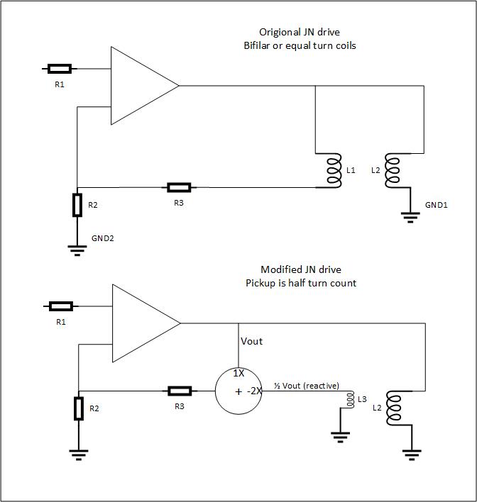

Here are both.It’s the proper moment to use your pencil to sketch it for us, John
George
The top is the normal diff drive. I have neglected to draw in the Ls/Rs, as we all know what is meant now by the circuit.
In the second one, the pickup coil is half the turns, so shows only half the dB/dt. So I double it at the summer, and subtract it from the vout. The net effect is the same, the output of the summer will be Rs of the drive coil. (was unable to easily find the greek symbol for summation in this version of visio..sigh)
John
You forgot your "emergency" resistor? 🙂
What the heck, live dangerously. I mean, how delicate is a #49 awg wire anyway?
jn
jn
Yeah, you could hang a lot of atoms off the end of that wire... 😀
