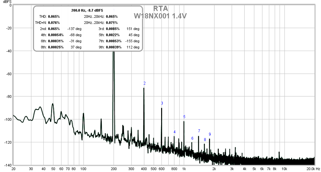

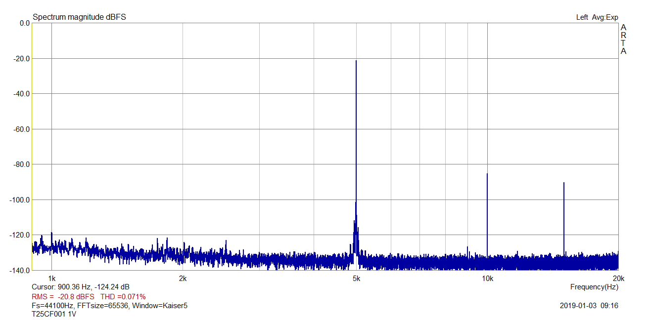

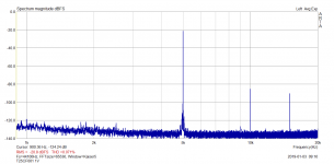

Pavel, how about this. Do a 200Hz single tone THD test, calibrated to frequency response and phase. Then post the calibrated .wav file. Say 60 seconds. Since magnetic distortions follow input phase, we should be able to deconstruct the residual into harmonics and that will show us where on the wave the nonlinearities occur.
Hi keantoken,
another quiet morning, so I did the 200Hz >1 minute measurement, the link is
http://pmacura.cz/w18.zip

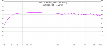

Legend: the file is stereo, 44.1/16. It starts with "silence". Left channel is microphone record of the 200Hz tone from W18NX001 woofer, measured nearfield, 1.4V at woofer terminals. Right channel is the electrical 200Hz excitation signal. So you can directly read time delay between acoustic and electric paths.
Because of the nearfield measurement, with the 6.5" woofer, the data make sense to some 700Hz. So please restrict the analysis to H2 and H3. The W18NX001 distortion at 200Hz/1.4V is pretty low, like 0.06%. Dynamic range of measurement is high, so we can see even very low level details and also noises of transformers of appliances etc.
I have the REW measurements saved, so, I can link them in the PM, if needed.
(Yes the power amp used is the class A sub 0.001% distortion)
