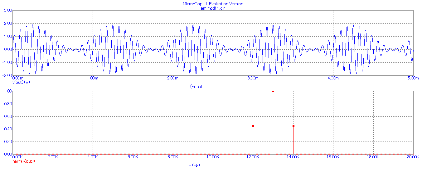

Yes, AM and a twin-tone are two different things. Twin-tone has visible envelope at F2 - F1, but no spectral line at F2 - F1. AM has base + sidebands.
Exactly as the mathematical operation predicts, AM, FM, or simple addition.
