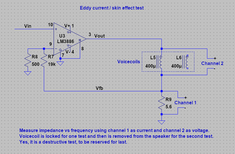

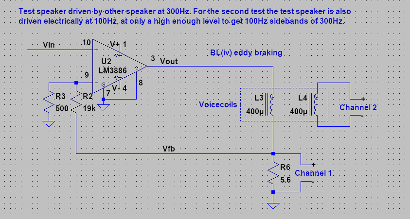

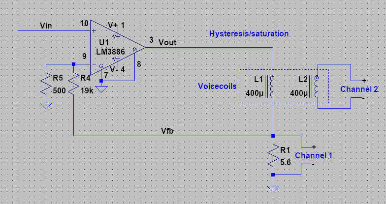

As Demian requested here are some schematics showing what I want. jneutron, can you tell me how to change one of these to reflect your proposed test? Then you won't have to repeat it over and over again...
If you can't do all the tests, do at least jneutron's test.

Hysteresis/saturation test:
1: lock the voicecoil
2: drive the first coil with current drive
3: record the drive current and second coil voltage, hysteresis can be extracted in software.
BL(iv) eddy braking test:
1: Drive the speaker with another speaker at 300Hz and record the second coil voltage.
2: Repeat, but with a LF current drive say 100Hz of the first coil, recording the second coil voltage. Use as low a current as possible to get a measurable result. Eddy current braking modulated with the LF current should be observable with the cone velocity being reflected as 100Hz sidebands of 300Hz in the EMF.
eddy current / skin effect test:
Measure the TS parameters beforehand if possible.
1: Measure impedance vs frequency with the voicecoil locked, in addition to LCR meter reasing at as low a frequency as you can get a reliable inductance reading at.
2: Measure impedance vs frequency with the voicecoil outside the magnet, also in addition to LCR meter reading at the same frequency as the previous LCR reading.
This should tell us about skin effect in the voicecoil and eddy current impedance in the magnet.
Ideally I would like to be able to extract inductance vs frequency from these measurements, which is easier if you can provide CSV files (or if you can do it with your software, make real vs imaginary impedance vs frequency charts).

I don't know a way to lock the cone that is nondestructive. I'll set up to do JN's tests tomorrow if I don't get sidelined. Your tests are more involved. I may be able to drive with another speaker nearby and look at what happens with amp connected and not connected. . . I can measure the acoustic SPL at the speaker during the measurement. Will that be useful?
It's better to keep the amp connected and just turn the 100Hz input on or off, then the speaker sees the same impedance in both tests. I think the SPL would still be useful.

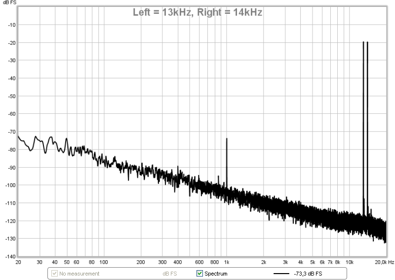

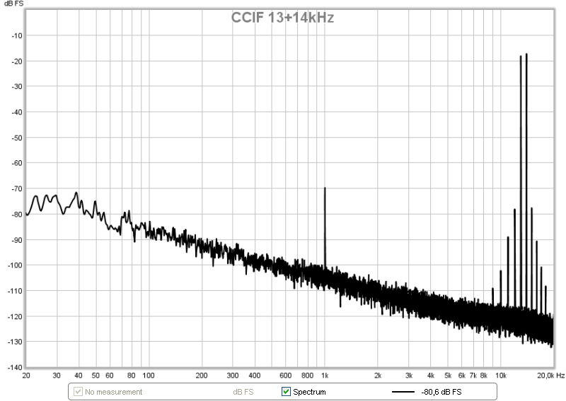

Will try to measure a set of twin tones / multitones with both pure current drive and your scheme. Unless I'm at the edge of my mic and preamp distortion (will make IMD sanity check with two drivers each playing a single sine) I hope to get meaningful results. I think one scheme should provide less acoustic distortion overall, preferably over a wide freq range and general parameter variation (level, notably).
In a second step I look forward to isolate the distortion with a real music signal, subtracting the recording from the source signal convolved by the measured impulse response via log-sweep at an adequate level. It's hard to acheive a deep null with acoustic measurements but we can actually listen to the diff signal and get insight because it magnifies the perceived distortion even when the residual is still dominated by linear differences. Crash-course on distortion character perception, of sorts.
Yes, important.
Yes, important.
Interesting that the mike picks up the 1khz beat frequency from the two sources.
I believe that to be an artifact caused by the single diaphragm. I also believe that human hearing will not generate that.
This is an important thing to consider with imd tests, as we cannot stop the mike from displaying this.
