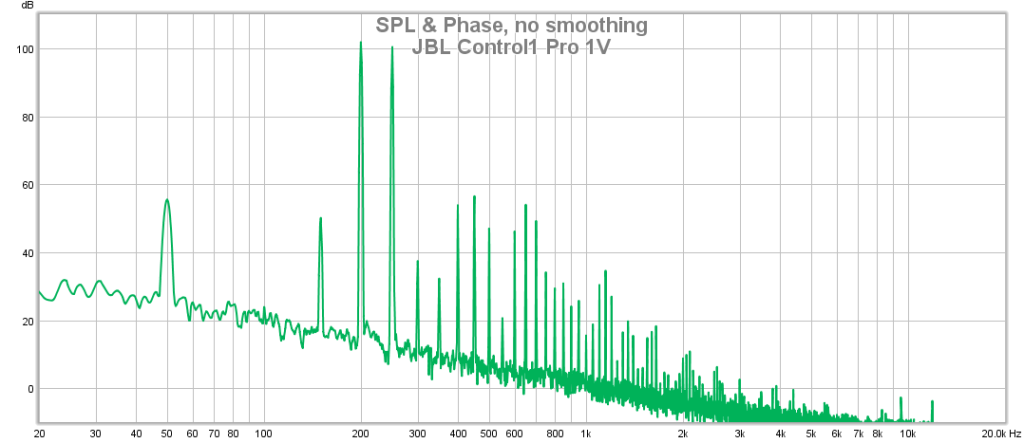

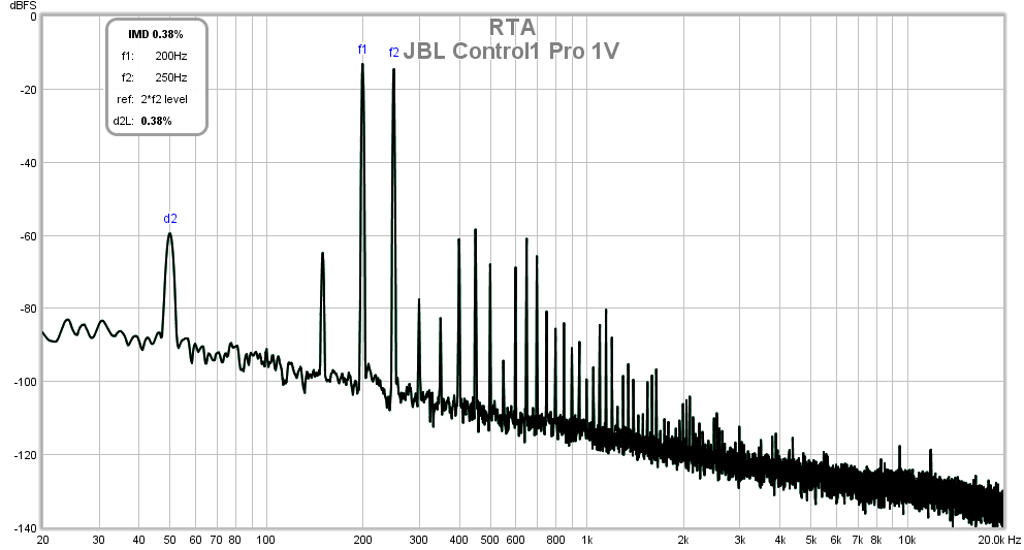

I would like to add one more measurement of 200+250Hz IM distortion, now with much worse speaker - JBL Control1 Pro. It is measured at 1Vrms at speaker terminals, more voltage would bring too much components related to case buzz etc.

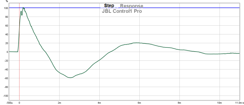

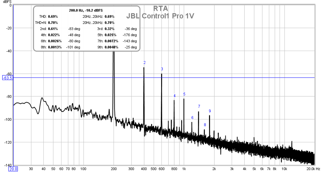

We can see that distortion spectrum has a lot of high order harmonics, which is confirmed by a measurement at 200Hz single tone. Attached is also a step response, especially for JC. It is almost optimal, isn't it? 😀

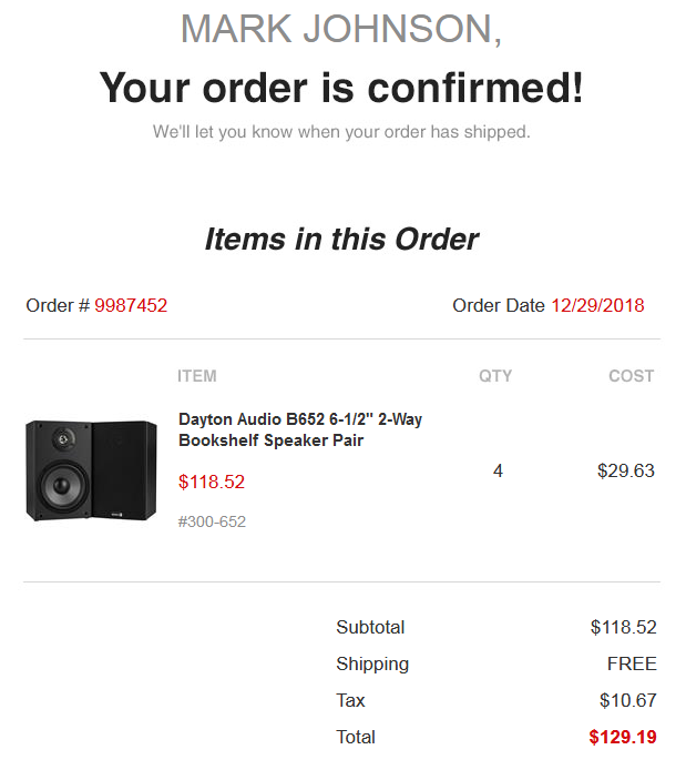

Thank you for the heads up. I just ordered four pairs and paid $130 including tax and shipping.
