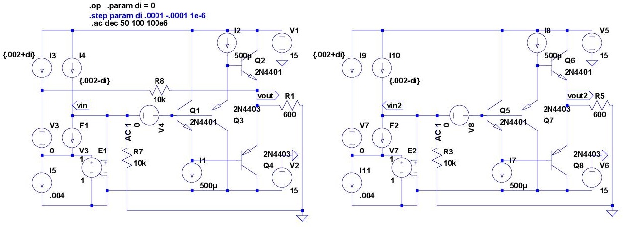

As promised here is another take on the error correction method we were talking about. This one is something you could actually build out of curiosity. It is a correction for the input to output voltage error on a simple diamond output stage which would include offset, crossover, thermal memory, and output resistance.
To illustrate things more clearly I turned this into a simple differential in to single ended open-loop amplifier. Using labels from the left circuit (the one with the EC "feedback"). I3 and I4 would represent differential input from an input transconductance via something like a folded cascode. The load would be R7 (10k) so a 1.0S gm would give you a gain of 10,000 (80dB). V3, F1, and E1 are an ideal representation of the bootstrapped current mirror which allows simulating everything without unreal negative components.
It is true that if you disconnect R8 from the output and use it as an input the current mirror chases its own tail and the circuit rails to one rail or the other, but connected as shown it is perfectly stable with perfectly matched components and ideal sources. Yes even if the diamond output is replaced with an ideal VCVS it is stable.
Stepping di (a delta in input current) from 100uA to -100uA the output roughly goes from 2V to -2V as expected. The right circuit without R8 has about .4dB gain error (almost exactly what you would expect from the 25 Ohm output resistance at 0V re: 600 Ohm load) and for a DC sweep the "S" shaped tanh Vbe error is seen (some call it gm doubling). The left circuit is perfectly linear within base current errors and the AC gain is exactly 80dB. The offset is accounted for also by the different betas on the N and P transistors.
The frequency response is modest due to the simple diamond, the input C and 10K limit it to about 3-4MHz. Which brings me to the point. If you inject a voltage into the loop, V4 (which represents an input to output voltage error) there is still 60dB of attenuation (at the output) of it at 800kHz. So the question is where does the effective GBW of 800MHz come from? No it's not somehow from making an ideal current mirror, you can actually disconnect R8 from the output and using it as an input catch the output at around 0V and do an AC analysis. The gain is around 60dB, I suppose because the transistor's bases are a DC load very slightly unbalancing the 10k's, and the GBW is the same 3-4MHz as the amplifier.
I'm actually going back toward defending the original statements. By conventional feedback thinking you have an error inside the loop you need loop gain to reduce it.
