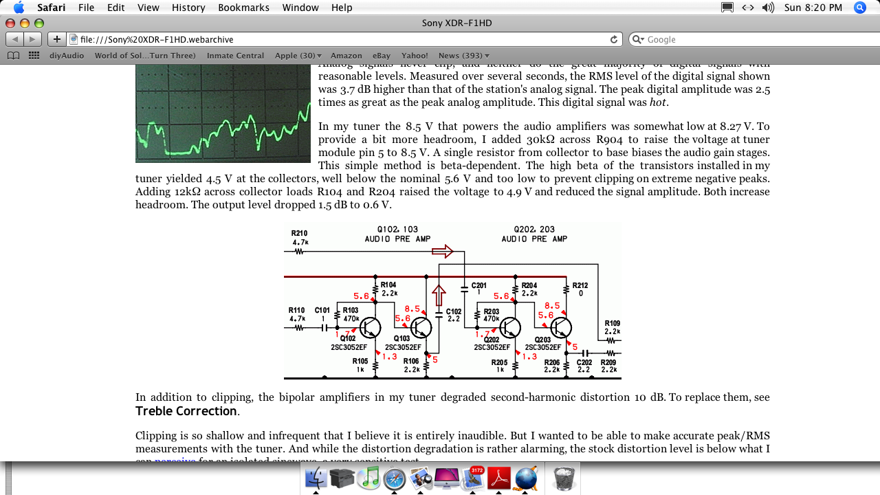

I like the idea of the philosophy, but don't see a strong enough consistency for avoiding a good, well chosen, capacitor if it's easier and/or better for topology.
My current fav input cap is under $1 and 5mm leadspacing, and same for a feedback cap. Maybe I'll upgrade to a REL cap that Richard help usher in, maybe I won't care once I have it.
And I never have to worry about DC.
How many designers out of midfi are really trying ceramic caps? Even a ProJect phono thing ($150, has USB output) that I have used lytics in the stock form. I swapped them with some Blackgates and have little complain about now if I use it. I'm just not sure whom you are educating.
