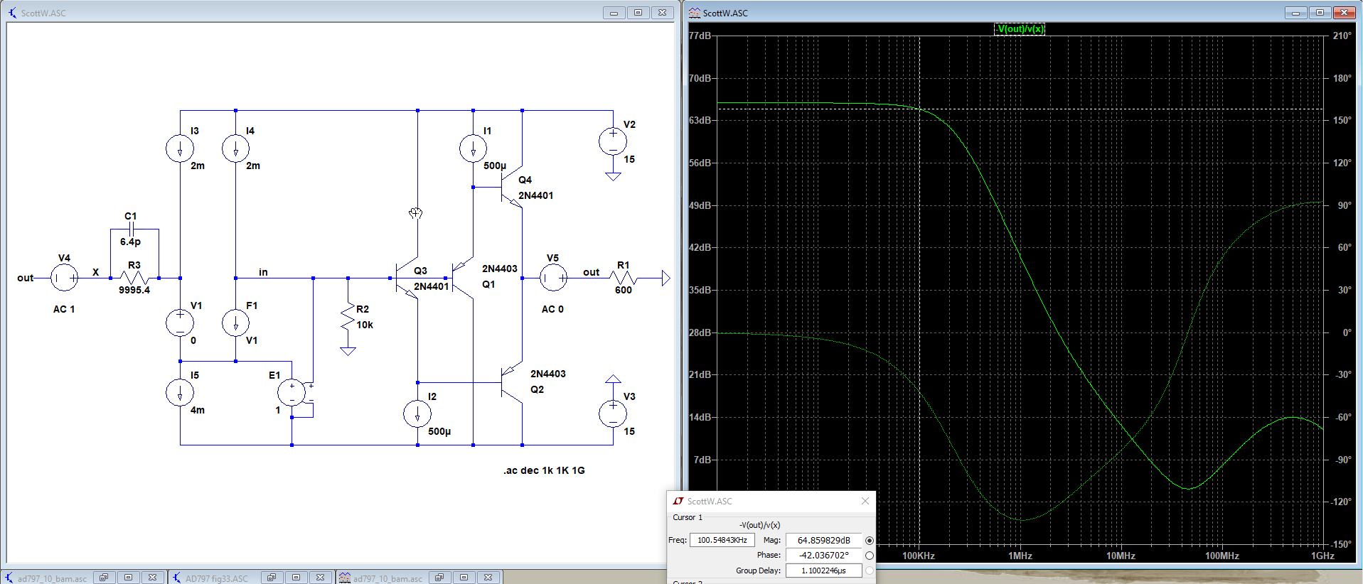

If you inject a voltage into the loop, V4 (which represents an input to output voltage error) there is still 60dB of attenuation (at the output) of it at 800kHz. So the question is where does the effective GBW of 800MHz come from?
I'm not sure I understand you. I would expect attenuation due to the bandwidth of the diamond buffer regardless of feedback.
You can measure the feedback loop gain by putting an AC voltage source in series with the 10k and mesuring the ratios of the voltages either side of it.

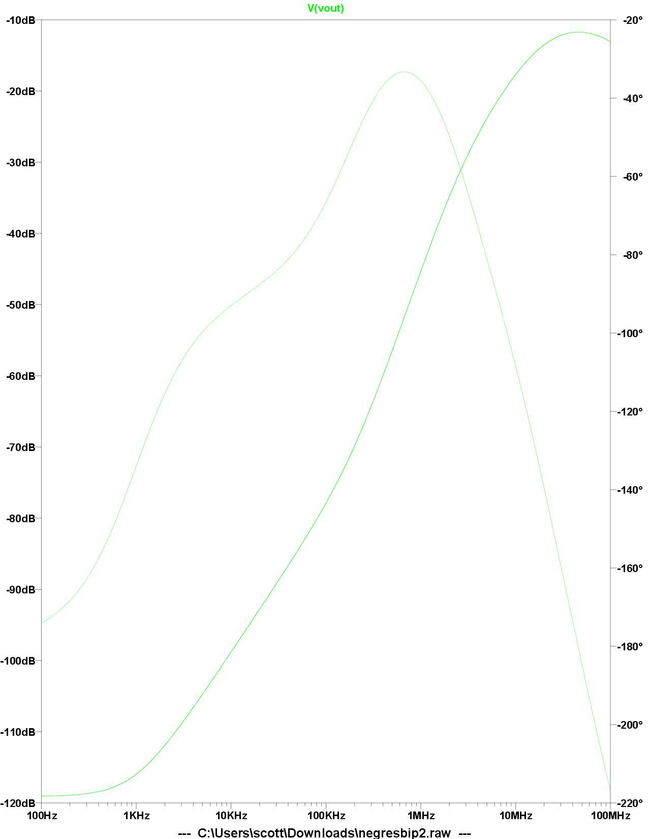

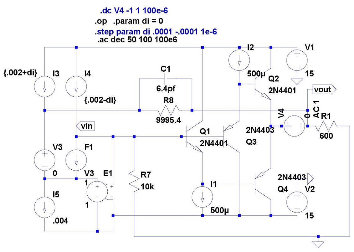

Sorry my last pictures were in error, the point where I injected the signal buffered the input impedance of the diamond buffer. I wondered why the balance did not need any tweek. It should have been at the output, so since this is an open loop circuit a source in series at the output appears unattenuated without R8 and C1 which are adjusted to compensate for the input impedance of the buffer (R8 is just slightly smaller and C1 is close to the input capacitance of the buffer). I included a plot of the AC output for a 0dB injected signal. The result is closer to what was expected (the 20dB/dec transitions into 40dB/decade at high frequencies).
The answer is the same, the signal at the output is attenuated by 78dB at 100kHz, by normal feedback arguments this is a GBW of 800MHz. I still argue the operation has more elements of balancing an AC bridge than feedback. Removing R8 and C1 gives 0dB flat at the output now. A better diamond buffer would be more useful because AC and DC input current errors are not nulled.
EDIT - The low frequency null is very touchy so in practice the 20dB/dec part of the plot tends to be hidden.
Not following you here driving the bottom of C7 with a source simply gives -.4dB at the other end rolled off by 10k and Cin as expected. C8 is equally unremarkable nothing that would indicate the net result.

before I go to sleep here's a quick plot of the feedback loop gain. I think my circuit is the same as yours.
That looks right 66 or so dB at low frequencies but the rejection ratio at DC is 120dB or so, more importantly I also forgot to mention that as you trim it goes through extreme rejection and back up the other side (like nulling a bridge). I might play some more tomorrow since we are about to be buried in snow again.
