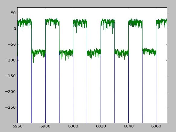

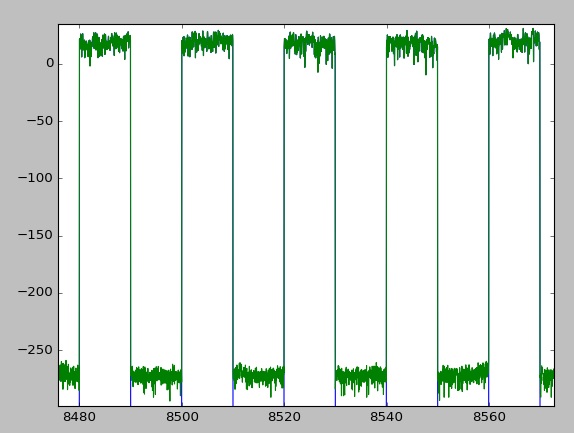

If I may interject a technical post here, I hope folks will indulge me. We discussed noise floor modulation with respect to very subtle DAC differences. I suggested an extension to the multitone test which comprised a selection of real music with regular portions of the spectrum removed so that one can observe the empty spaces being filled by non-idealities in the system transfer function.
I took 30sec from the first track of "The Final Cut" by PF and removed via FFT filtering 10Hz bands at 20Hz spacings. The result is still recognizable as the music (via listening) but very strange. The pictures here are the filtered data and original data filtered showing the noise floor of double precision FP. The second plot is adding a 0.01% second harmonic distortion giving the theoretical -100dB noise floor. I think the key here is that simple distortions in the signal path now appear as a modulation of the noise floor.
Disclaimer - This is something I just did as an experiment I make no claims of it having any rigid scientifically valid applicability.
EDIT - The entire cut is filtered by an FFT of the entire length, so yes Virginia you can do absolute brickwall filters without any windowing, etc.

How did you do it? Which tools? And which FFT to see the results?
I would imagine that the music would be mostly recognizable with some weird qualities to it. Our hearing processes are very robust for getting content from noise.
Python and numpy no stupid power of two FFT restrictions. I just did a real FFT of the whole 30 sec (1440000 samples) and removed bins and did the inverse FFT.

Thanks Scott.
Very interesting and intriguing!
Questions:
1.The 30s file was a recording from vinyl rip?
2. What you show is:
The first screenshot is from the original content and the second is from the one with the added distortion?
Now a friendly suggestion
Either you make a step by step article for real dummies and no hackers or you will be flooded by e-mails with attachment of test samples for you to analyze and post results. You don't want that, do you? 😀

Vinyl rip?
Can you do the same thing for the red-book version and same excerpt? 🙂
If this method holds water I think this may be the key to progressing digital audio to the level promised as I believe that music correlated noise tails are a (the) real party pooper. If it becomes measurable, it will be mitigated. So the hero is the measurement inventor.
If would love to be able to do it myself so I second the request for a cook-book recipe.
A wonderful contribution - thanks!!

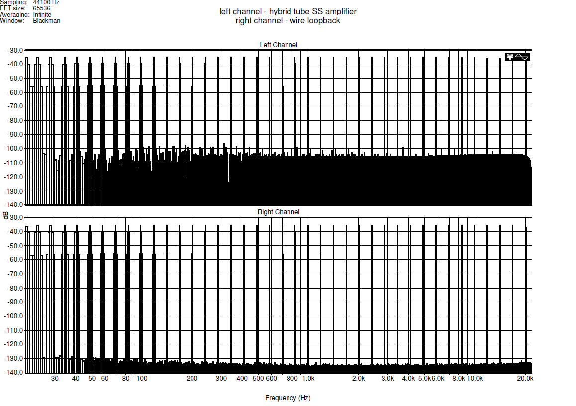

We can see apparent (apparent because it is a visual effect of many intermodulation lines) noise floor elevation or "modulation" in a multitone test as well, in case that distortion is high enough. Still, it does not seem to make an audible difference.
Can you tell original file from tube amp record? - test

PMA - maybe the distorsion you add in your last test is not the worst kind. I'm thinking of one that is (maybe) generated by D/A converters - or A/D.
I understand what you mean, but please take into account that we speak about -40dBFS vs. something like -110dBFS (or even less). And the DAC/ADC "distortion" is included in the tube file distortion, which is being compared to the original file (original rip).
For the fun of it, yesterday on a german forum I posted a similar listening test like yours, using the original file vs this file recorded three times in a row through a RME Adi-2 Pro in loopback, with the cheapest RCA cables I could find. I'll most likely post it here, too (just trying to gather some experiences first).
