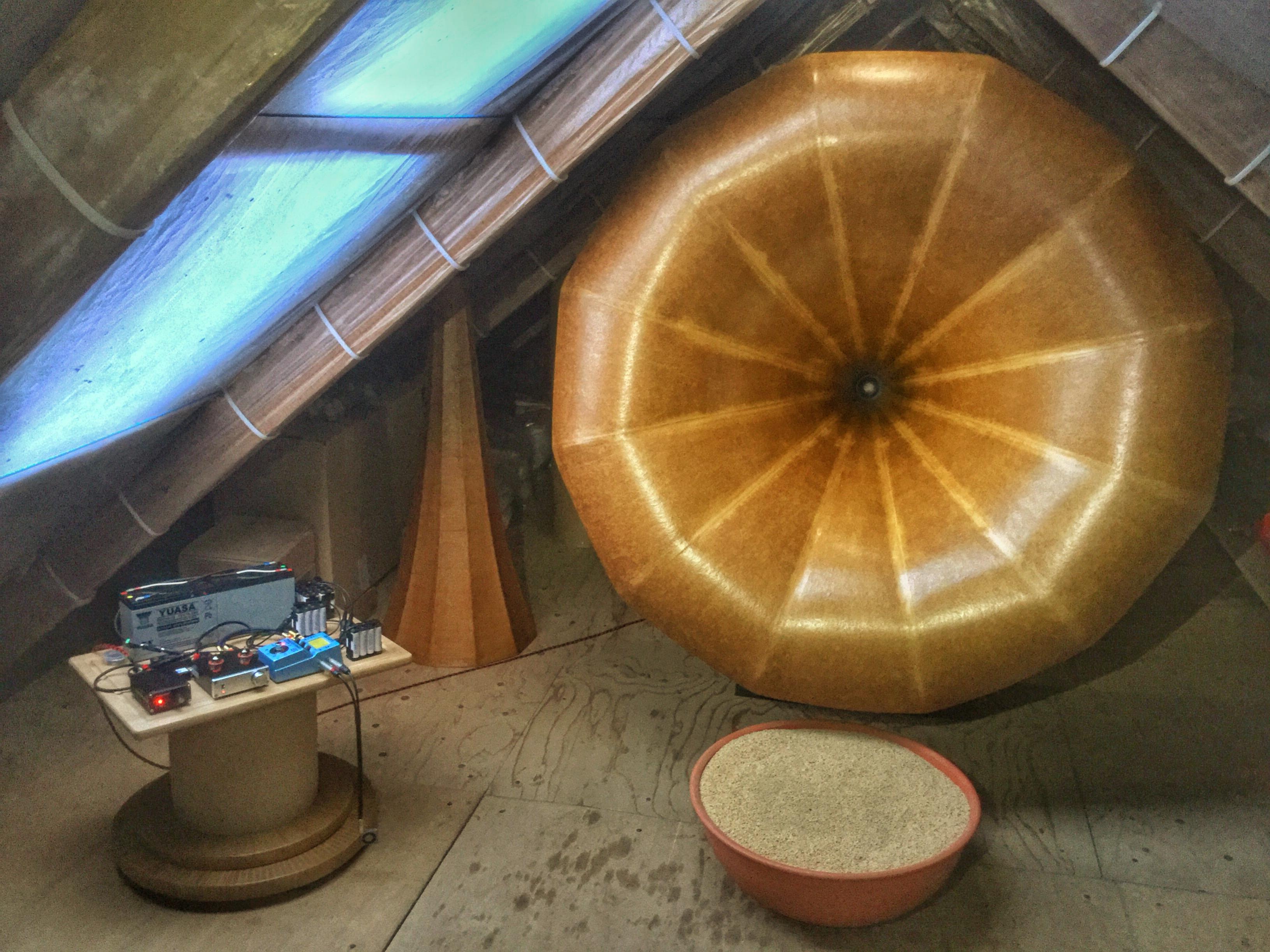

the horn in the hayloft
The making up of harmonics, wherever it happens, is not beyond the realms of possibility, however, I can't see how this helps when it comes to reproducing the music.
I don't see it so much as reproducing the music, more as making the music happen for you. This is why I said last weekend 'if it sounds good - it's high fidelity'....... and well and truly got my Internet bottom kicked on that one. We listen to music as aural art, and I always keep this understanding close to my heart, as well as inside the (relatively) empty space between my ears. Enough.
Have a look at the picture of the horn. I took it today while down in the barn cutting and chopping wood for our stove. Every 15 minutes or so, I goofed off for a rest and a listen, and came to the conclusion that the less eq at 50hz, the better the bass. Tighter, more focused and helped the music groove right along. Amazing how a single drop of just 1db can make to open up the overall soundscape.
While listening, I also realised why it was that the soundscape in the mids would at times sound blurred. I don't think it is the speaker, I reckon it's when complex multitracked studio based stereo recordings are summed to mono, and what I am hearing is phasing in the sound. In particular, tracks with rapid panning or stereo chorusing. It just sounds horrible, as the horn is ruthless in its portrayal of music.
I do have a very good little line signal gizmo box with all the right resistors inside to properly sum stereo to mono, even though the mono class d power amp takes a 3.5mm stereo input and sums the signal at the end of the bridged dual mono output, it seems less 'troubled' using the gizmo. Perhaps I am deluding myself........
All the electronics are off the shelf - cheap - and the synergy between the components is more or less perfect now. The valve buffered preamp is actually a solid state + valve hybrid, and really makes a sonic difference. All the interconnection cabling is studio quality, not cheap but not too spendy. The array of batteries all provide more current than actually needed, and really helps the music stay intact.
I'm hooked on the full range single speaker sound, and in some respects find stereophonic sound (like 3D cinema or 3D photography) a bit of a hindrance more than anything. However, I do have a 'high end' NOS Paradigm single point stereo ceiling speaker that I want to incorporate into my next single horn speaker build. I really like the idea of the soundscape portrayed as a stereoscopic - nay - holographic, bubble of sound.
I have had twin speaker stereo playback systems before, and have always found myself somewhat dissatisfied with the 'unresolved argument of opposing dualism' of them - much in the same way I have never really enjoyed paintings presented in the form of a diptych.
Anyways, anyone with something to say or ask - just go ahead, I'm easy.

Thanks for the picture 🙂 I didn't realise you were listening in mono, and yes, mixing stereo down to mono is not ideal, do you notice a difference with mono recordings? I'd be tempted also to try less EQ, I use a little boost around 10k for my hearing loss, the only other thing I do is cut an annoying room resonant peak at 40Hz, I refrain from using any boost low down prefering to adjust my listening position.
Woow!
