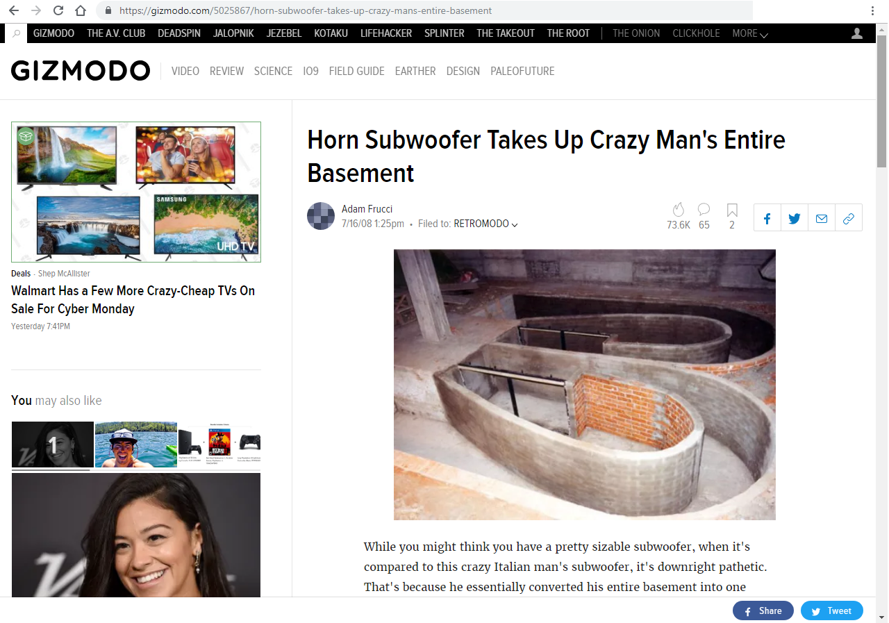

I tried to fix it but something strange happens and a whole screen gets filled with letters and symbols.
Anyway copy on your browser this line
gizmodo.com/5025867/horn-subwoofer-takes-up-crazy-mans-entire-basement
and then patch infront of it the https://
It will get you there

This is a proper link, awsome, but must have been quite pricey to build. Possibly about the same as some of the silly season high end stuff.

Roberto should start demonstrating his system with a ticket. He will recover some of the cost.
