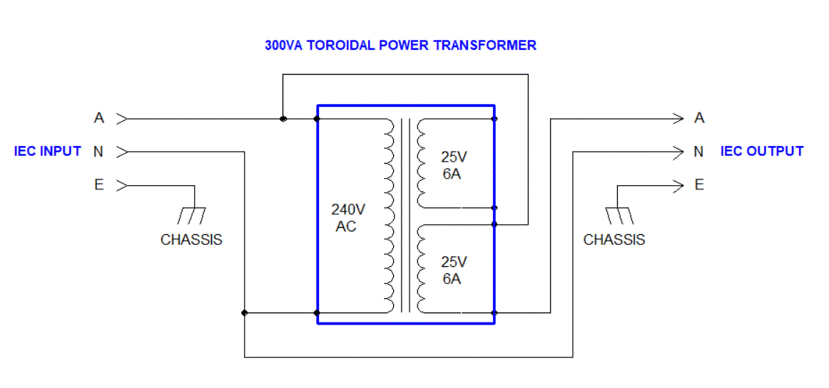

Something left field, I was cleaning out cupboards of stuff, sure like other of you guys we get accumulations that ends up in various storage places. I came across something that was traded-in (more like the guy thought he was trading-in, but that was news to me) of some sorts, even forgetting who it was. There were these two ABS boxes saying "Power Conditioner" and these toroidals inside. I saw the it was a 240V AC Primary 300VA transformer and sketched out the IEC input and out. This is what I got, any comments as to how it 'conditions' the AC. Seems like via cancellation.

Joe, what is sketched is a line voltage booster or reducer depending on the phase of the secondary.
I had thoughts about the phase as well, got little info on the side of of transformer, and both AC Primary wires are Yellow, but going on the exit points of those wires, I am pretty sure I got the phase right in that quick schematic I did in my CAD drawer.
I just measure it and yes, it does reduce by about 25V AC. The line voltage went from 240V to 216V, so you are right about it being a reducer.
But does it do more than that? The fact it is claimed to be a Power Conditioner implies that line noise is reduced. So if it only reduces by 10% across all frequencies, then this is just a piece of junk, and this guy "Daud Pranoto" made a dud.
When I get time, I will have to figure a way to measure it. Does it filter with increasing frequency, in other words, is this a low pass filter? May have to hook up the audio analyser and put 20 Hertz and upwards through it, maybe 10V RMS level and a dummy load. If this really works, then neat.

....I just measured it and yes, it does reduce by about 25V AC. The line voltage went from 240V to 216V, so you are right about it being a reducer.
Hi Joe.
Here in Perth according to age of suburb, it's normal to measure 245V at the wall socket, very often 250V, sometimes 255V....old 250V AC standard.
This item of yours would drop AC to 220V<230V which is ball park for European AC voltage devices. For Tube amp transformer/rectifier derived HT supply the mains voltage is important, I expect this box provides safe operation of Euro tube gear on WA mains supply, and any claimed filtering is a bonus.
