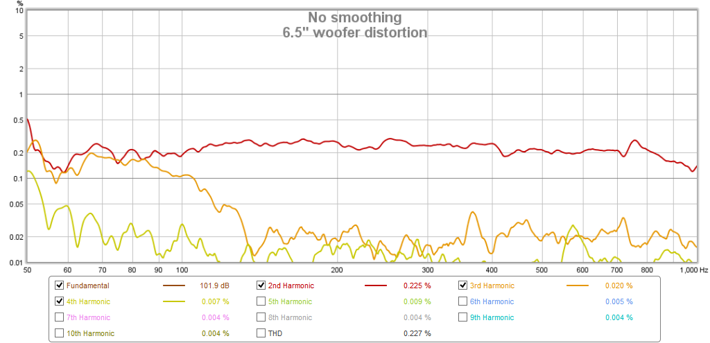

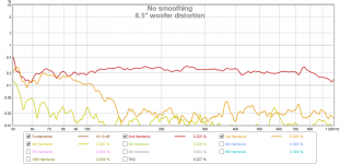

My measurement was done about a week ago, on SEAS W18NX001 driver. This is a nice small woofer with nextel coated paper cone. It keeps low distortion, in 0.1% order of magnitude. That's why I have shown it, as I do not like colorizers compensated by even more colorizing SE tube amplifiers.
And, for a multi-way speaker, any simple formula of trivial distortion cancellation is an illusion. If you ever worked seriously with speaker drivers, you must know what I mean. Otherwise I am just sorry.

Thank you for the woofer data Mr. Macura, I fully agree with your statement I quoted above. I take it that you find bi/tri/quad amping using LLXO of little significance.
