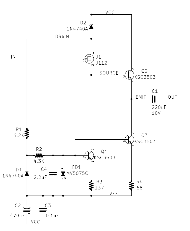

Except your cite did not have any data even remotely showing an order of magnitude change with normal bias. Typical X7R is 10% or so and you don't use them where noise and instability matter. You are just making stuff up, especially noise what on earth do you mean?

I use X7R ceramic bypass capacitors in situations where the design needs a "BFC", in other words, a Big Frriggin Capacitor, and I want to fit it into a small space. For example, capacitor "C4" in the attached schematic is an X7R ceramic capacitor. You can see that it's a bypass capacitor, its job is to keep the voltage across the LED rock solid and constant, while input square waves with 5 nsec rise time are jerking the Ccb capacitances of devices Q1 and Q3 up and down, ferociously. Circuit works well, measures good, sounds excellent.
Do I care whether the capacitance of C4 changes by 25% when the voltage across it changes? Nope, as long as it remains Frrigin Big. Do I care whether the capacitance of C4 changes by XX% when the ambient temperature changes from -25C to +75C? Nope, as long as it remains Frriggin Big. All I want is C4 >>> Ccb; in other words, C4 is a Big Frriggin Capacitor. Of course the excellently low ESR of ceramic capacitors is also a benefit in bypass situations like this one.
On the other hand, for coupling capacitor C1 I chose a Nichicon UES green-sleeve "MUSE" bipolar electrolytic. It's not a bypass capacitor though.
