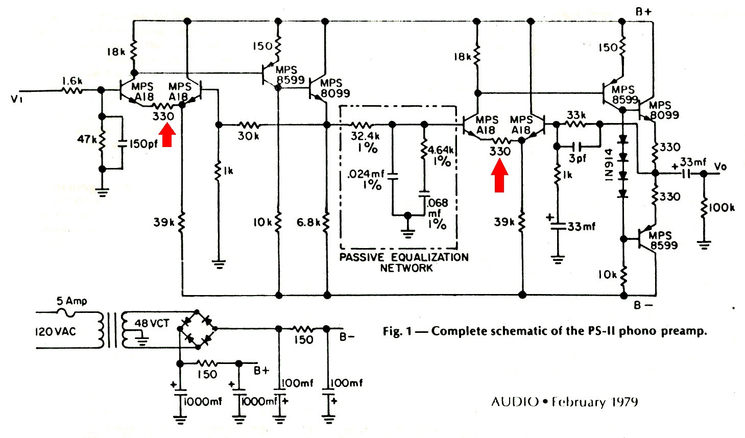

Intentionally creating 2nd harmonic distortion, in a 1979 product (!)
I found this schematic in Audio Magazine, February 1979. The article was a product review of a phonostage sold by PS Audio, a company that is still in business today. See attachment below.
Each of the two Long Tailed Pairs is intentionally unbalanced, by adding an emitter degeneration resistor (330 ohms) to only one of the two legs of the Long Tailed Pair. This creates 2nd order harmonic distortion and apparently that was a design goal. Somebody knew something, long long ago.
One way to think about the circuit is this: Imagine that the 330 ohm resistor is a potentiometer, whose wiper connects to the 39K bias resistor. With the wiper at the midpoint (165 ohms left, wiper, 165 ohms right), the circuit is balanced. But the designer has intentionally chosen to turn the pot all the way clockwise, and now it's (330 ohms left, wiper, 0 ohms right). The circuit is no longer balanced.
By the way, with ±32V supply rails, the circuit ought to have huge amounts of overload margin, even though the equalization is passive.
Isn't this just an ersatz Apt-Holman input with degenerated NPN instead of FET?
In the sense that both of them use ThingX on the left side of an LTP and ThingY on the right side of the LTP, where X!=Y and more importantly where gm_X != gm_Y , yes they both do that.
However I favor the explanation that there is a balance potentiometer which the designer has deliberately twisted all the way to the endstop, "with malice aforethought", to intentionally unbalance its operation.
But that also hints that there is something about deliberately unbalanced inputs. Maybe?
Oh yes.
