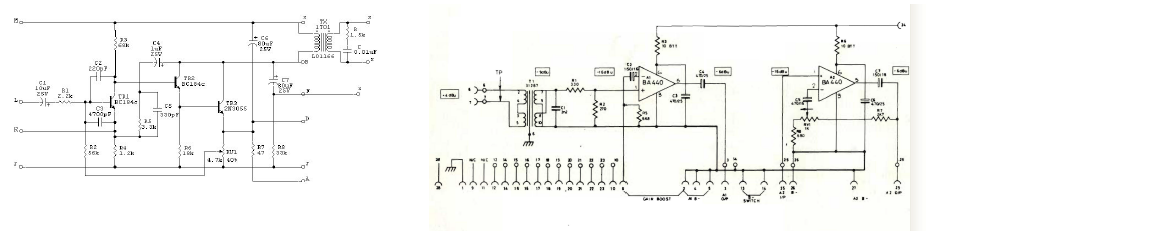

My understanding of neutralization is that it is used to reduce the effects of feedback capacitance of a device by adding feedback of the opposite polarity. In most cases neutralisation is negative feedback to counter the intrinsic positive feedback.traderbam said:My understanding of neutralization is that it is used to reduce the effects of input capacitance of an amplifier by positive feedback of the output to the input via another capacitor. Like a sort of bootstrap. A drawback is that the positive feedback may increase distortion.
Where I may be making a mistake is that it looks to me like the AD797 makes Cn add negative feedback, the opposite of neutralization. Hence -Cn in my diagram. This time the negative feedback should reduce distortion. Otherwise wouldn't Cn have to connect to point B in Fig 33?

For some Neve schematics
Schematic Vault (Neve) - Dan Rudin Recording & Production

Well the AD797 isn't complying with either of our definitions so I don't think the term neutralization applies to it.My understanding of neutralization is that it is used to reduce the effects of feedback capacitance of a device by adding feedback of the opposite polarity. In most cases neutralisation is negative feedback to counter the intrinsic positive feedback.
More apt was an analogy to a gyrator creating a -C. I was simply trying to make the point that there is no sensing of the error and amplifying it a lot in an additional conventional feedback loop. The operation is easy to demonstrate with an ideal current mirror and a few sources. If the output buffer is ideal the correction capacitance is bootstrapped perfectly and the main loop GBW is still determined solely by gm and C. The error in a real buffer is small and only enough -C is seen to cancel it. If I can find the AC plot of the output impedance the gyrator action is more clearly seen.
I was simply trying to differentiate the operation from what I have seen in other EC schemes where the delta Vbe in the output is measured, amplified, and used to create a compensating voltage. Here the effect of the voltage error is replicated as a current and injected in the opposite sense.
That would be helpful.OK, if I have time I might have a plot to clarify.
YesOne more time though, the output buffer has a voltage gain of nearly 1, the extra capacitor is connected into the opposite side of the current mirror so it is -C (more exactly the current in C),...
That's a little unclear. I get the current through Cn. Where is the other current coming from?...the crossover distortion is a voltage error across the output buffer and the derivative of this voltage is an error current which is exactly (at low f) the same and opposite in sign from the error current in the compensation capacitor, they add to 0 (at DC and less so as f is increased).
I have simulated the feedback loop (in Fig 33 of the AD797 data sheet) formed by Cn around the unity gain output buffer A (which I have given an arbitrary pole at 10MHz), in the absence of any input current from the input stage. This loop is unstable when Cn=Cc (as predicted by my maths).
So I'm curious as to what the values of Cn and Cc are in the real op-amp. If they are the same you must have had to make the loop stable by some other means...?
Years ago I simulated the AD797 compensation/cancellation and put the result in this thread. It worked exactly as Scott had described.
Sure. This is a feedback loop around the output buffer. It doesn't affect the overall gain of the buffer except at higher frequencies where it extends the buffer's bandwidth.I was simply trying to differentiate the operation from what I have seen in other EC schemes where the delta Vbe in the output is measured, amplified, and used to create a compensating voltage. Here the effect of the voltage error is replicated as a current and injected in the opposite sense.
When you look at HEC implementations you'll see the same effect. A near unity gain output stage has a loop put around it which has high loop gain; the gain cannot be made infinite and stable at the same time so total distortion elimination is impossible. There is no "cancellation" in an arithmetic sense going on at all; it isn't a feed-forward system.

I'll search for it.Years ago I simulated the AD797 compensation/cancellation and put the result in this thread. It worked exactly as Scott had described.
Cc and Cn are exactly the same and the triple-darlington has more BW so at 50-70MHz there is a small pole zero network but that is not fundamental to the basic operation. The phase margin was pushed a little hard because applications for the noise performance are predominantly at substantial gain and input snubbers can almost always be made to work.
For sake of argument let the output buffer be ideal then Cn can't do anything including making any loop unstable. The plots are on the data sheet they are with an external 50pF mica IIRC and the internal Cc is 50pF +-10% or so. I used a 10pF plus 47pF ceramic trimmer for optimizing the plots in my AES presentation.
EDIT - jcx did the same as PMA also, and I think I posted an SK170 input version with generic 4401/4403 bi-polars for the rest of the circuit.
EDIT EDIT - See figure 21 on DS for output impedance (with Cn falls at 40dB/dec rather than 20) same holds for distortion components. You might also be confused in fig. 33 the operation of the current mirror and bootstrap forces A and B to be at the same voltage which is also the output voltage.

Once again, I have to go back into the past. In 1974, while hired to construct a new recording studio in Montreux, Switzerland, I was going to make an all discrete board with Levinson quality designs that I had prototyped. At this time, I was approached by a Swiss couple (American wife) who wanted to invest into the recording studio. Their one insistence was using a Neve board for the heart of the recording system. I politely declined, and it was to my regret. Ultimately, they fought for control of the studio, and won! So after 1 year of prototype development, we were without a studio to put together.
Now, what if I had to do it over again? I was very idealistic at the time, and I knew that Neve made a GOOD but not SOTA electronics. It had a good sonic reputation, better than most others, except earlier tube consoles. I should have compromised, as I had with the Studer mastering recorders that we ordered. I could have 'fixed' any moderate oversights, and saved myself from a lot of work building an entire console myself. In fact, my vision was a console to record classical music almost exclusively and it was not versatile enough to do pop music at the time. It would have been better than the Neve in overall clarity, but limited to live performances almost exclusively.
Now, what was wrong with the Neve console, and what was really good about it? First, looking at the discrete schematic, you find the lack of PNP transistors. This is because silicon PNP transistors were not as popular with the British as they were more expensive at the time. In the USA, we started to use small signal silicon PNP transistors in audio since the mid-1960's because they became available from Motorola, only slightly more expensive than their NPN complements. Ampex made similar circuits as Neve, but with a few more PNP transistors, in their tape recorder electronics at the time, and they sounded OK as well. Usually we used DC Biased Tantalum caps for input and output coupling, as they were popular then. Aluminum was really large in those days, so was avoided if possible. Ceramic compensation caps were also used that could distort at the extremes.
Now what was GOOD about these designs?
They were class A, input to output, for one.
They had pretty good gain bandwidth, because they were not limited by IC processes.
They subsequently had a fairly high open loop bandwidth, because they had very limited open loop gain, as well. (gee, what do you know, could this be a good thing?)
They used selected transformers for input and output, keeping out a lot of RFI, etc.
There may be more, but I can't think of them at this time.
In any case, while I designed more sophisticated circuits at the time, these early discrete designs could be pretty darn good.
In hindsight, the discrete designs made by Studer, Ampex and Neve, are still classics, that can do better than most later stuff with cheap op amps, etc. "Old 'amps' for new!" '-)
