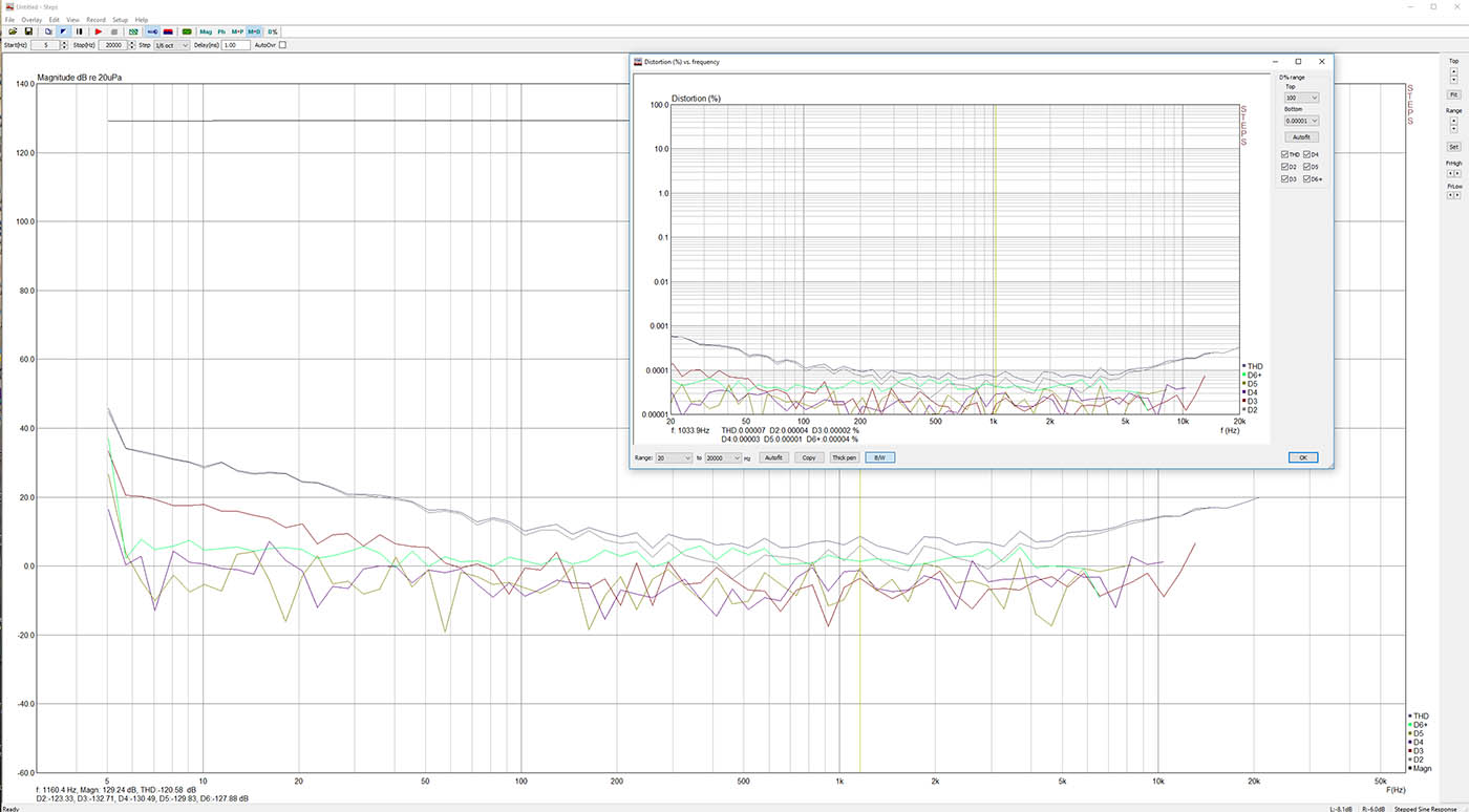

Note Benchmark DAC3 with nasty 8 legs gets 0.0006% 3rd harmonic at full output.
Which is not SOTA. See below measurement of Chinese AK4497 board after some re-engineering:
