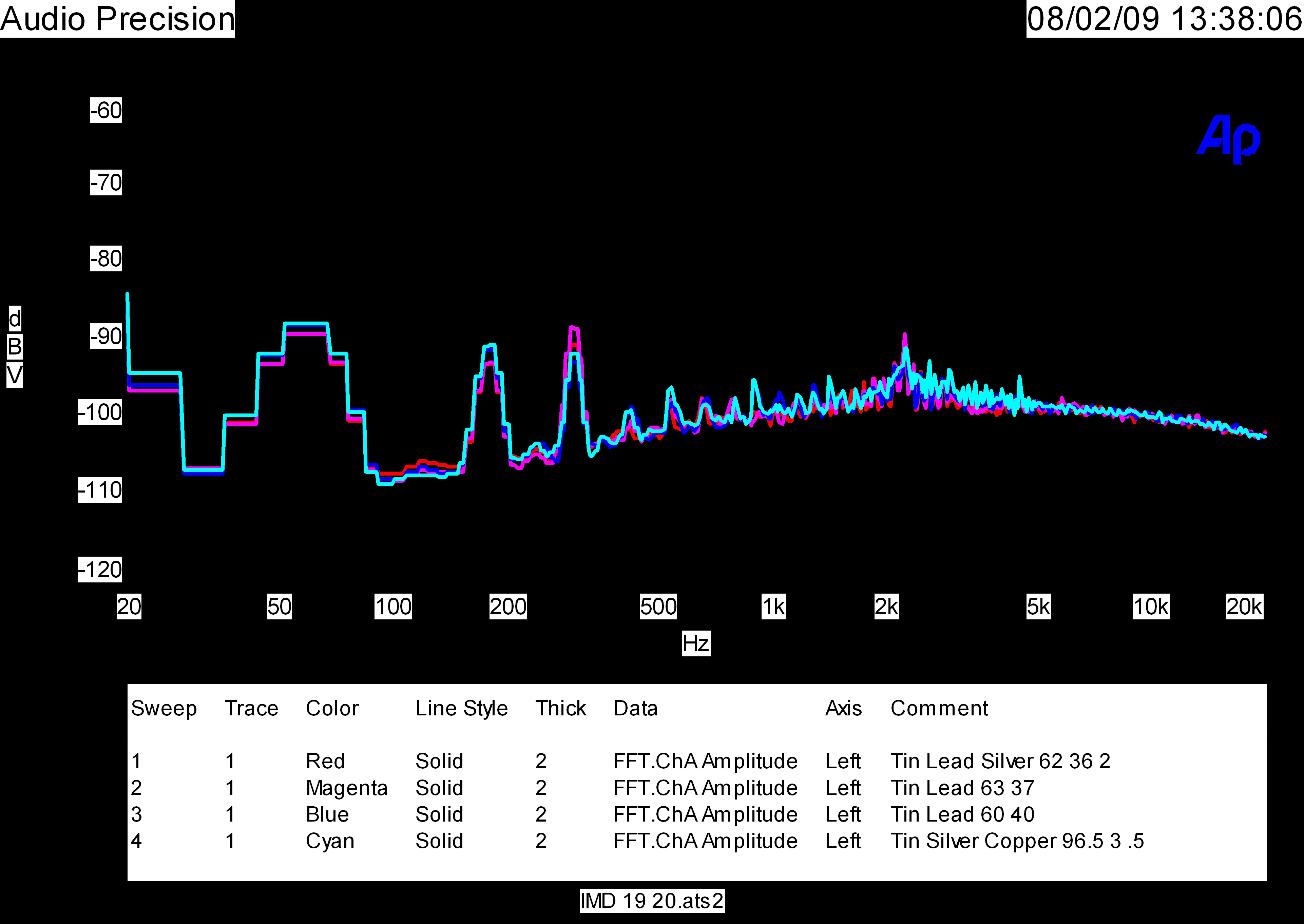

I have attached the original experiments on solder joints. This is what I consider to be the baseline of resolution. Note the noise floor through the filter establishes that. Not any real distortion difference between 200 solder joints of four different solders.
BTY the gizmo provides 56 dB of gain.

I think you can see the difference between the baseline and the wire results.
