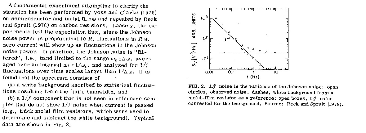

Thermal noise. White.
Excess noise, may be 1/f, may not appear at all. I'm sure I read somewhere that metals don't have significant 1/f noise.
Correct on both. I've learned not to make absolute statements because I've been reading the literature on this for 40yr. For those interested, this is from my link of a day or so ago. Notice the reference thick film metal resistors, white. The experiments here were probably done under fairly rigorous conditions, I expect nothing less.

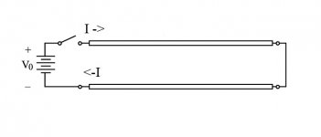

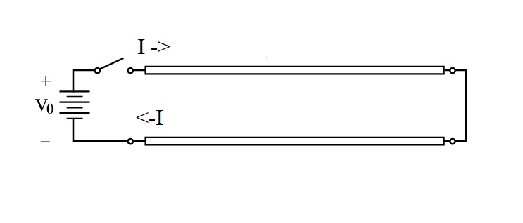

If I may be so rude as to offer a picture, closing the switch initiates both currents instantaneously and the line maintains constant charge. Or maybe someone could tell me how one end of the line knows how to wait for the other? BTW it does not matter at all if this is an open line transmission line or a circular loop, in the later case a 3D field simulator would help with the tedious maths.

30 nanoseconds to get from one end of the interconnect to the other. Variation of pico seconds if for example we were sending a 0 to x volt square wave.
If it were instantaneous that would be a bit faster than the speed of light.
Same thing if you shine a flashlight at a wall from the time you turn it on until you see the spot of light it takes some time.
Please refer to the picture, you disagree that the current at each end of the battery starts at the same instant (throwing the switch) so tell me which end waits 30ns and how does it know? I could post the solution for an open wire transmission line which is a current staircase to infinity which straddles exactly the solution for the lumped L at low frequencies but that would probably be a waste of time.
Charge travels from negative to positive.
How does a TDR work, particularly on an open cable?

So, if I understand correctly, if one closes that switch and then (before the charge could reach the other end of the conductor [ns's...us's]) opens it, then that charge is captured by the conductor, reportingly doing this will act as, some kind of, a charge-pump.
Question, what is the maximum charge for 10Mtrs of RG58? 🙂
P.s. with the switch at the negative pole. With the switch at the positive pole one will (presumably) create a charge-vacuum.
P.s. Question, what is the maximum vacuum that 10Mtrs of RG58 can withstand? 🙂
