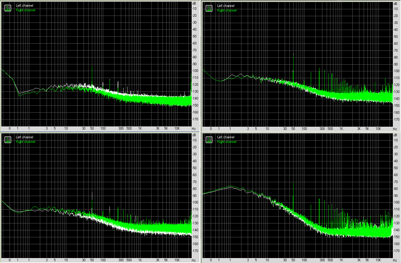

One volt. The gizmo has gain ahead of that. I will check that out when in the office.
Thank you Ed.
When I see so many harmonics of the main’s freq at a measurement’s FFT, I know it is loop pick-up. Either ground loop or test lead loop.
You have measured across the wire. The wire and the test leads to the differential amplifier have formed the loop, an aerial loop.
If you run this again, try to reduce the loop area. You will have a much cleaner FFT.
Attached are FFTs from the output of the same TT setup (arm on stand): M97xE+SME3009+TD160+single ended Aurak RIAA preamplifier to a passive preamp box, to an Maudio USB soundcard.
The only variable is the area of the loop formed between the tonearm shielded interconnect and the two grounding wires (TT’s and tonearm’s)
0dBFS is 1.286Vrms.
The 300Hz tone L+R at +18dB above 0VU of the HFN test vinyl record, gives –16dBFS output on this setup.
