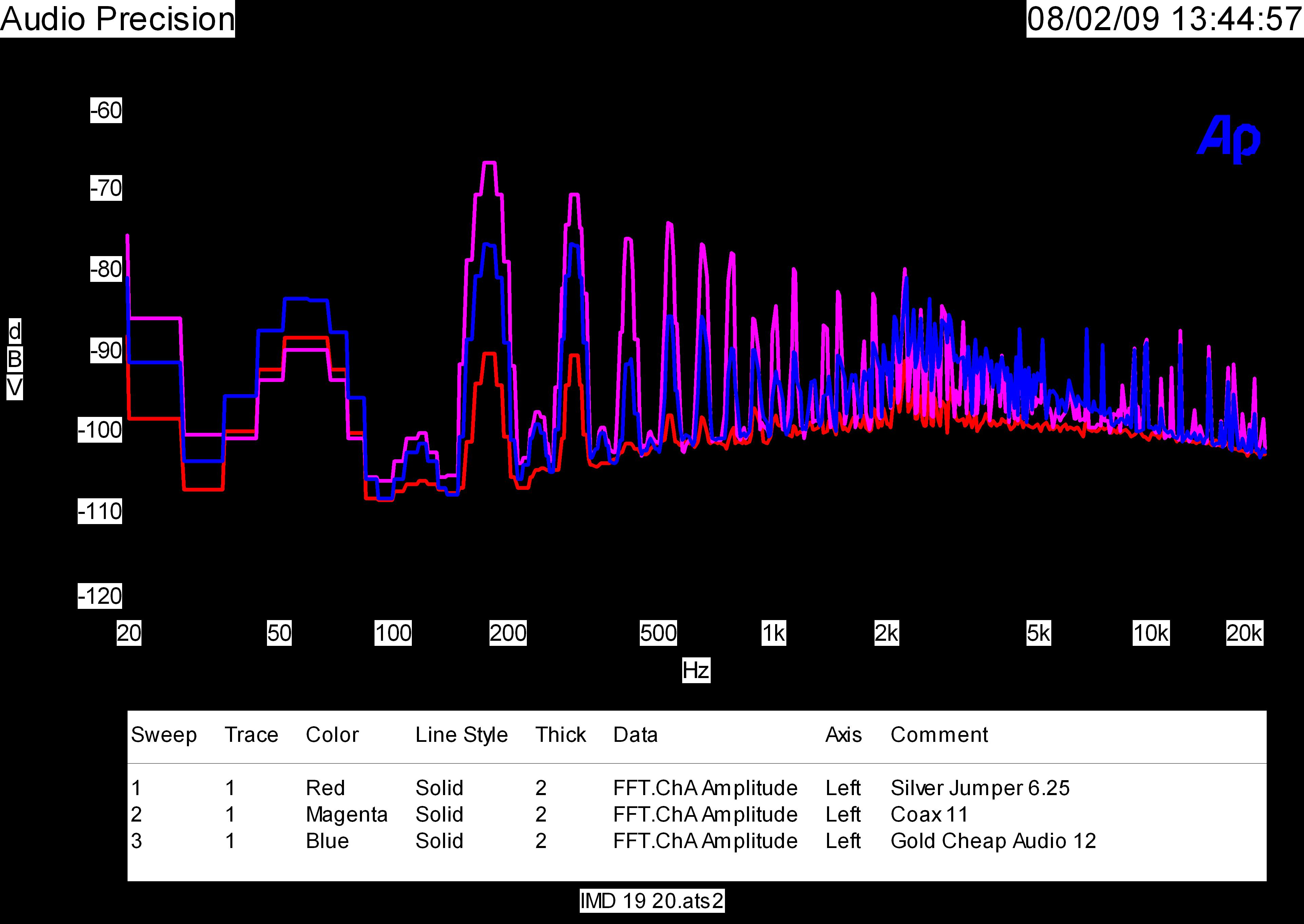

Attached are my measurements of three different cables. As cable diameter increases so does the intermodulation noise. Just for fun the cheap audio wire center conductor was .381 mm and the RG11 was 1.628 mm or 20 x log (1.628/.381) = 12.6 dB
Scott I can't see you behind that pile of peanut shells. I am not talking about mass vs velocity. It is all about path length variance.
