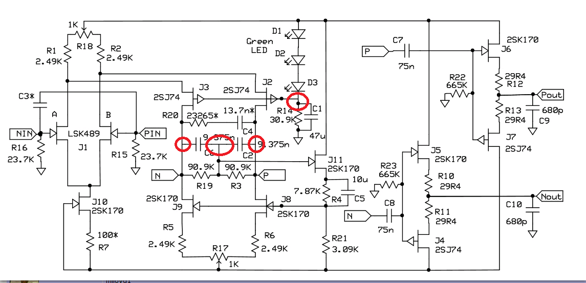

A simplified universal differential or single ended phono preamp
Patrick
I was referring to the connections on the schematic....perhaps they don't matter to the sim.
Dan.
I guess Scott hasn't it simmed yet.
Dan.
I have, it certainly works!
I love that common mode servo; You could say it creates a sort of virtual ground between the 90.9K resistors. You could call them I/V resistors.
-Alex
Dan.
Oh, ok.
The circuit is self explanatory even without those missing dots I think.
It is a very clever circuit based on current conveyor, not unlike the Blowtorch.
The signal current is generated by the front end diff pair.
And the entire R-C network can be considered as an IV-impedance converter with RIAA compensation.
But the most intelligent bit is the common mode servo.
It acts full band with no LP filtering referenced to Gnd.
If you add a Gnd referenced LP filter, the single ended outputs actually have more distortion.
I tried many different variants in Spice and in the end use a slightly different CM servo which has much better PSRR.
Requires one extra P-devices (I used PNP in my build) and a couple more resistors.
That is not a sim tool, I'm used to the artifacts of ExpressPCB. Patrick posted where the original plots are so I won't repeat them, but there is an RIAA response plot of the finished circuit. Jan also has the files on the Linear Audio site to confirm RIAA conformance using just a sound card. Patrick is right about improving PSRR, but I use batteries for mine.
It measures and sounds fine to me, I even used nothing but NOS TRW PS caps (hence the strange values). Patrick has posted several sets of values for RIAA networks with off the shelf parts.

I wasn't kidding and am a bit surprised no one else commented on the schematic.
What now, no supplies marked, the phase is switched, no bypassing????
No, just no second pass at labeling the parts, so the part numbers reasonably follow where the parts are located, not when you though of them.
As to phase among many they refer to it as polarity, a term I do not like as I am not immortal.
You got me on that one, I don't know anyone that does that unless they have OCD tendencies. Huge circuits are partitioned, typically a 100's section, 200's section and so on. They are in fact auto numbered by the software and going back over it is a needless waste of time IMO of course.

That is unless you added parts to a section. I just have the software auto-number the parts again. No wasted time to speak of. I'm using DipTrace these days.

It is nice when you go back to do it again after time has passed and memories faded. I even like to put the name of the circuit on the PC card so when I find loose ones later I know what it was for.
Hi Scott,
In this case there is no global removal/adding of part numbers. The software always picks the next missing one so AFAIK you have to do one at a time no matter what. I don't care in any case this makes no sense to me at all.
That is a good point, but the numbering does nothing for me, the schematic is visualized (for me) with no numbers or values at all.
