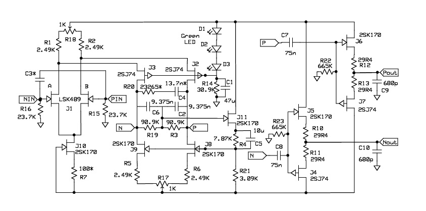

OK got it right this time. My phono pre for the foreseeable future. Class A open-loop no variation in frequency response with level, distortion that vanishes with level, +-0.1dB over most of the audio range. Has the sound of "no effects".

I think you attached the thumbnail...
What wierdo makes a balanced MM pre 😀

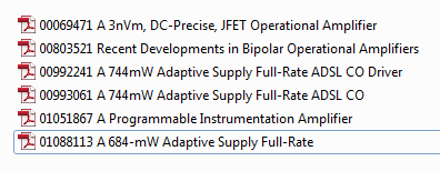

Even though I am leaning towards SE circuits I find that one very interesting.
Which prompted me to downloaded some of Scott´s papers from IEEE a while ago, at the university.
On another topic, for anyone who read Feynman... Don´t believe him when he says there is no science being thought in Brazil. There is some. There are intelligent people. I do agree with him that many are just memorizing things without understanding them. Not all.
It was an in joke. Scott knows that I am not only doing balanced MM, but in a silly way that requires ludicrous component matching and doesn't work with all cartridges. But I am not the only one.

For phono, the balanced pre-pre should be perfect, imho. Doesn´t vinyl have inherent second harmonic distortion?
