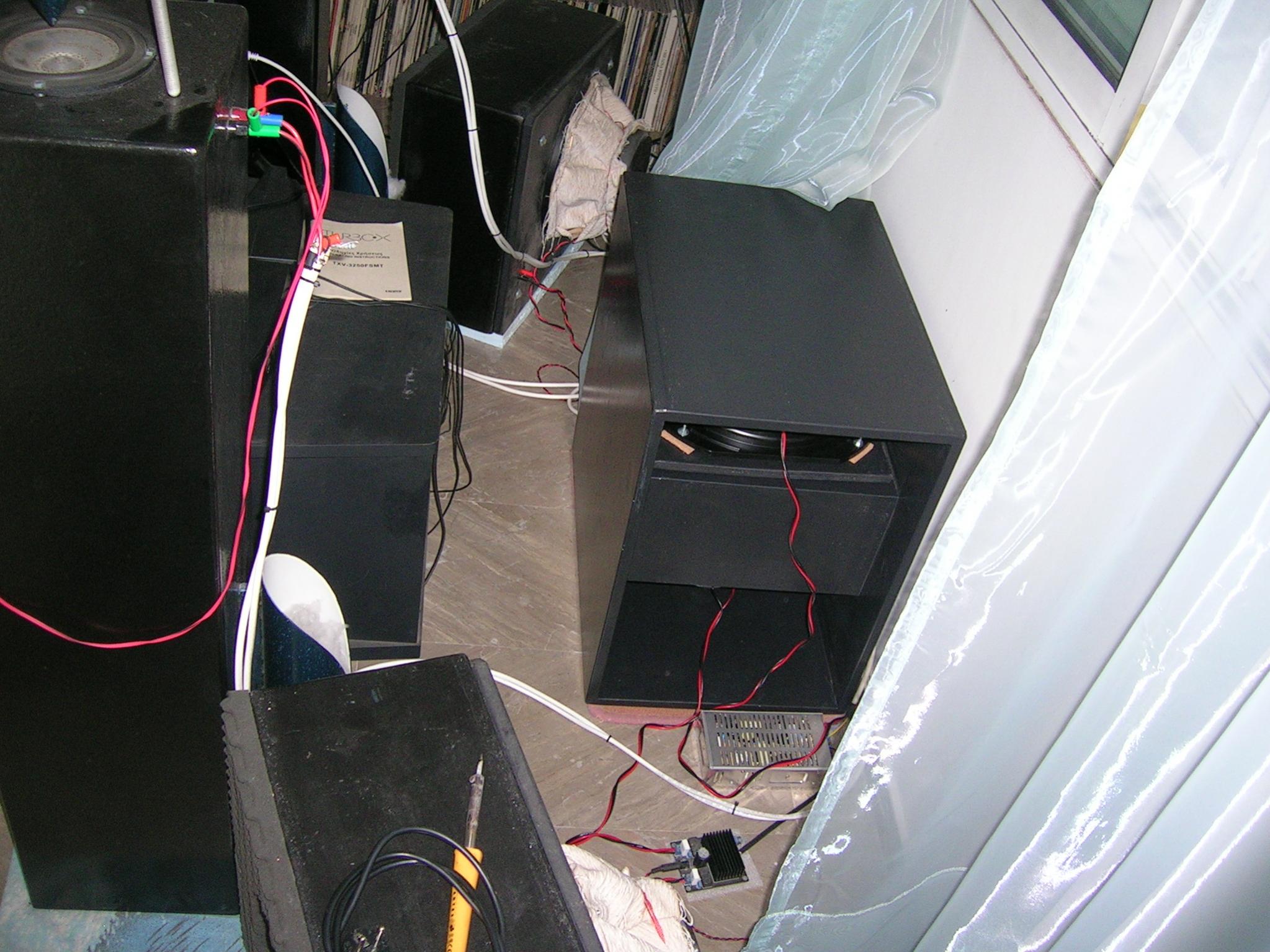

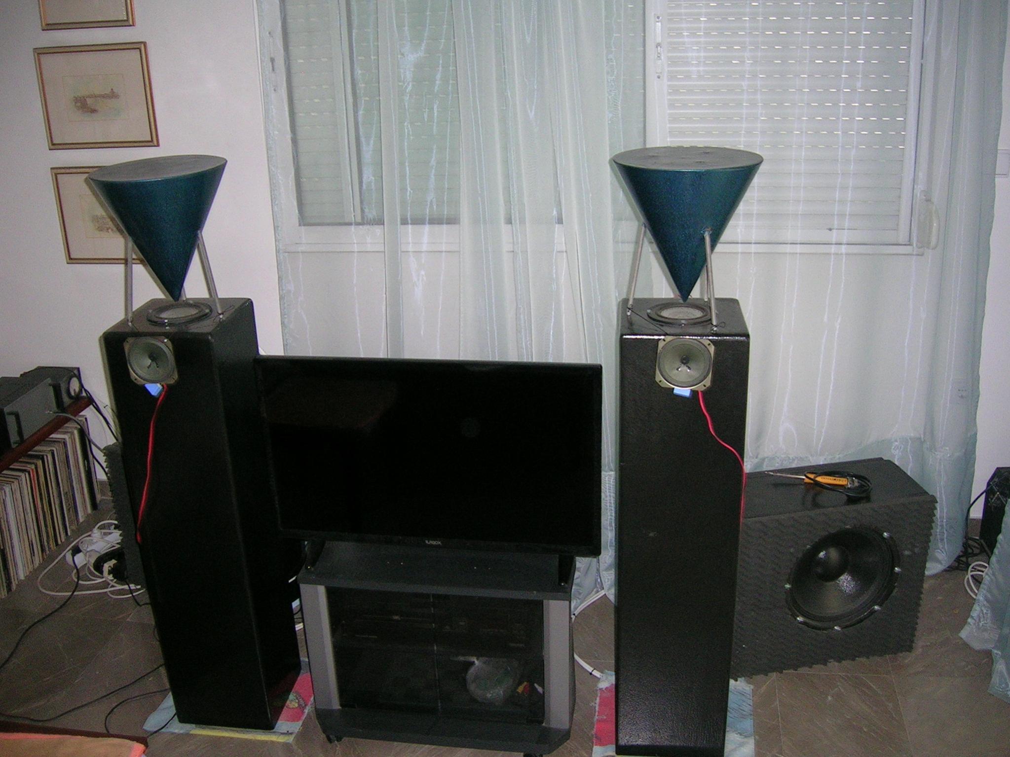

Regarding the current combination (one year cooking) for which I have the numbers.
The omni 4inch Jordan in 40Hz MLQW is high passed (Bessel) at 160Hz and a 12inch woofer low passed (Bessel) at 80Hz. Woofer’s cone is close to the port of the MLQW and 90cm away from Jordan cone.
I listen from 2m to 5m away
The adjustable delay is on the Jordan.
Adjusting from 0ms to 3.5ms (corresponding to a sound air distance of 0m to 1.2m) I hear no difference.
With a delay of 4ms to 4.5ms and above (max 7.5ms) I hear the bass beat becoming smoother and mellower, nothing else.
George

For an omni with No directivity.
Intentional. Some HF directivity added by the 3.5inch paper Hitachi facing fwd.
And listening in far field.
I can’t seat on a chair at a sweet spot just to listen. No way.
No room carpet or heavy drapes etc.
Summer version (May to Oct 😀)
Lots of delayed reflections
True. One meter from the wall is not what I want but it’s a living room. Heavy drapes in the winter make things better.
and room influence
Good for the kind of music I listen to.
The upper lows, mid and highs are good.
The bass section is still under adjustment
FWIW, currently I am running an active sub placed dead central between two tall narrow loudspeakers (bass-2 x 4.5", mid-1 x 4.5", highs-1 x 1" surrounded by acoustic pinboard) spaced 1.5m apart with an air mattress laying horizontally on top of the sub and firmly against the back of the L/R loudspeakers.
With this arrangement the sound anywhere in the room/house (and outside too) is delightfully clean clear, present and enjoyable...goes quite seriously loud too.
When sitting on my Ikea Poang chair placed into the nearfield, the L/R and depth imaging is 3D holographic due to essentially complete lack of early reflections caused by diffraction and cabinet rear radiation.
Notable also is the importance of fore/aft time alignment positioning of the sub and precise central positioning wrt the L/R cabinets....IOW the old conjecture that subs are position non critical is a complete crock.
With sub level and roll in point dialled in correctly the overall image positioning, clarity and musicality is better than headphones....bass chest/torso/leg vibration adds to the fun.
The only downside I find is the wide ranging variability in mastering of the low end...on general pop/rock music the low/bottom end is all over the shop and requires tweaking to suit/correct the particular track/album in play.
George, it looks like you are having fun with your system, but with your arrangement as I see it you have you have no hope of precise imaging or flat response, and with so much reflections you ain't ever going to optimise or hear time alignment.
