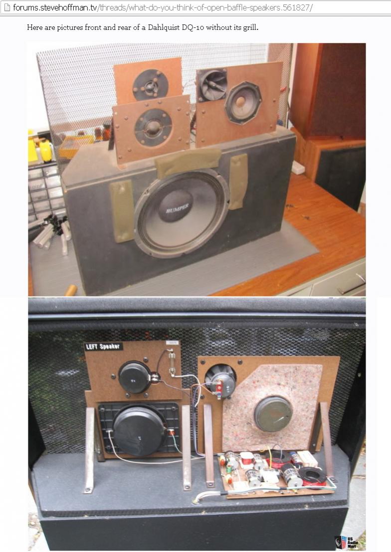

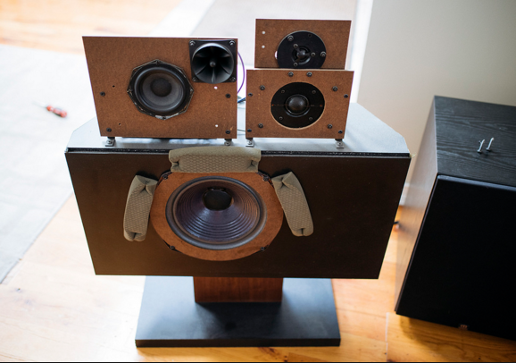

I didn't say they were bad... It's just clear they're bleeding diffraction everywhere. It wouldn't be hard to just cut some boards 1/4" larger than the existing ones on the correct edges, then give them 1/4" round overs. In a few places you might have to stick some absorbing material. Doing that might take them into the stratosphere.
Everyone would think that it would have been easier for the manufacturer to place all those four drivers on a single piece of board. Then why did they choose to cut three boards instead?
Masochism combined with luck of diffraction knowledge?
I don’t think so. Most probably they tested various ways of drivers placement and they ended in there through listening tests.
I know someone who would like to test that journey to stratosphere scenario.
George
That's easy. They cut the different boards for time alignment and baffle size relationship for desired frequency range SPL from each.
It always baffled me how they converged on a design with so many variables. There must have been some initial technical decisions like time alignment or impulse response.
The three baffles are displaced 5mm at most front to back from each other.
That maybe the case. SPL from vibrating panels (plus the SPL from diffraction).
i.e. voicing
George
i.e. voicing
Sounds like a non-convergent process. The first pic you showed looked like a re-cone on the woofer.
It all starts with wavelengths. They control baffle step loss and how far the drivers can be seperated based on crossover points. If drivers are too far you get comb filtering. Sometimes you can swap polarity to help widen the gap, but you have to watch stuff like phase. From there you can consider lobbing patterns based on crossover type. Usually based on driver selection a designer will be able to imagine the crossover type so that'll be in mind when also designing baffles. Different crossovers can reduce or increase comb filtration. Some use eliptical hard crossover points so the drivers basically dont cross and can gain some distance that way.
