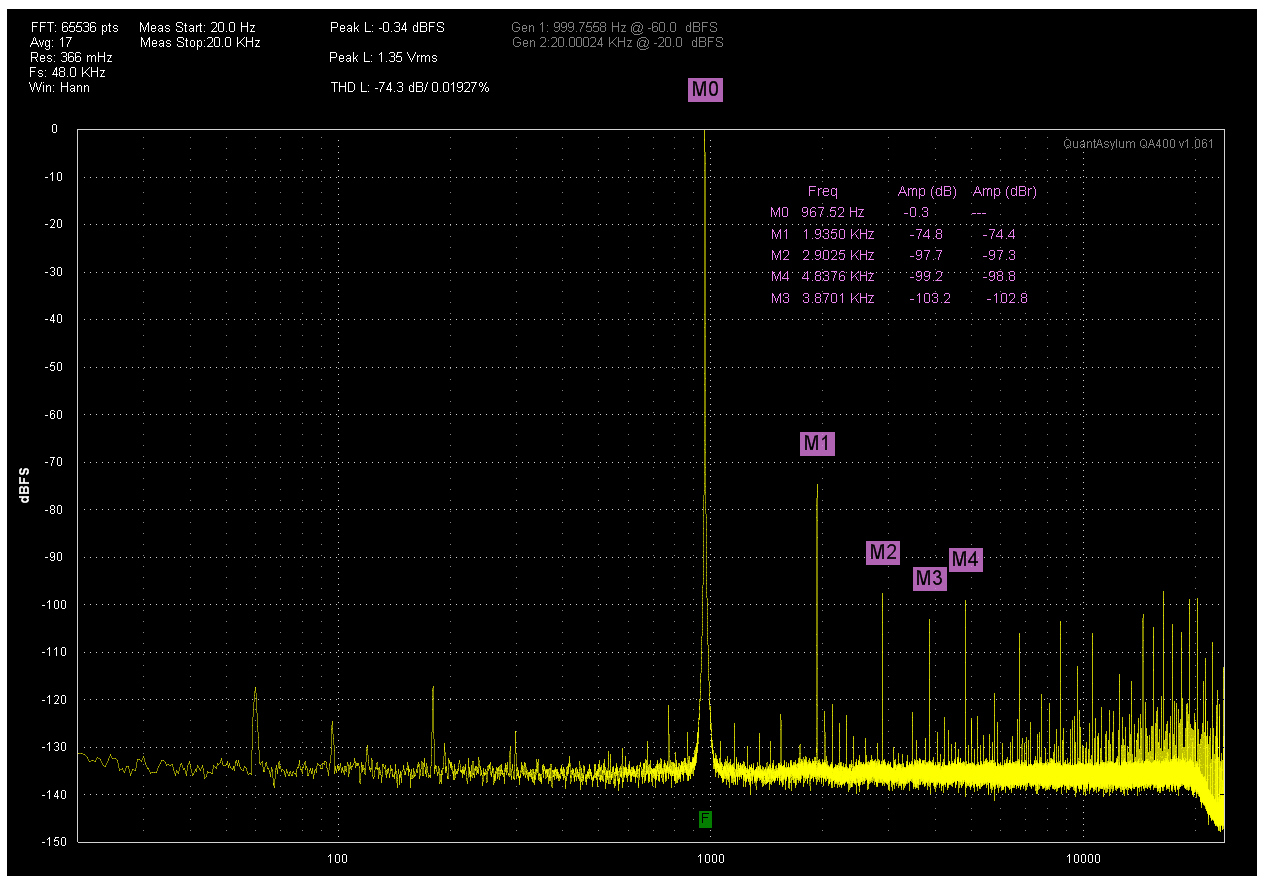

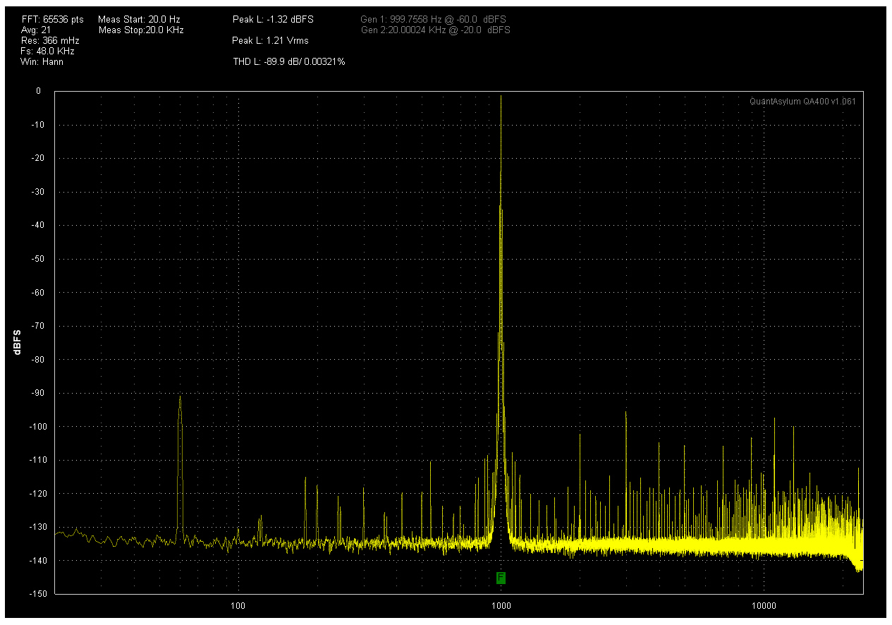

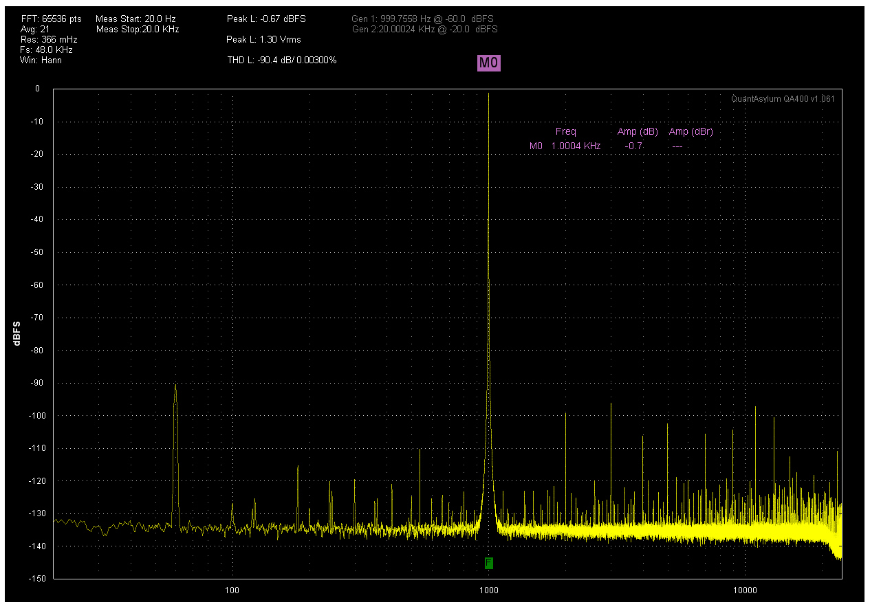

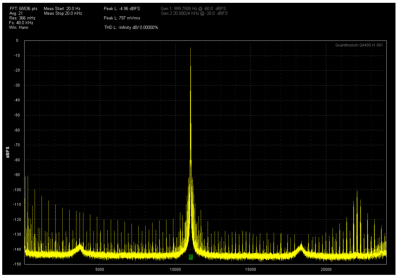

Last year I decided to test my self for jitter sensitivity with an interesting result, I'm not good to hear jitter. I took a CDP and replaced the xtal in the oscillator with a lower frequency one and than with an old Marconi RF generator with AM and FM modulation ability. Here's the 1kHz tone seen by the QA400 ,first with a wrong xtal and than the Marconi RF unmodulated. More to follow.

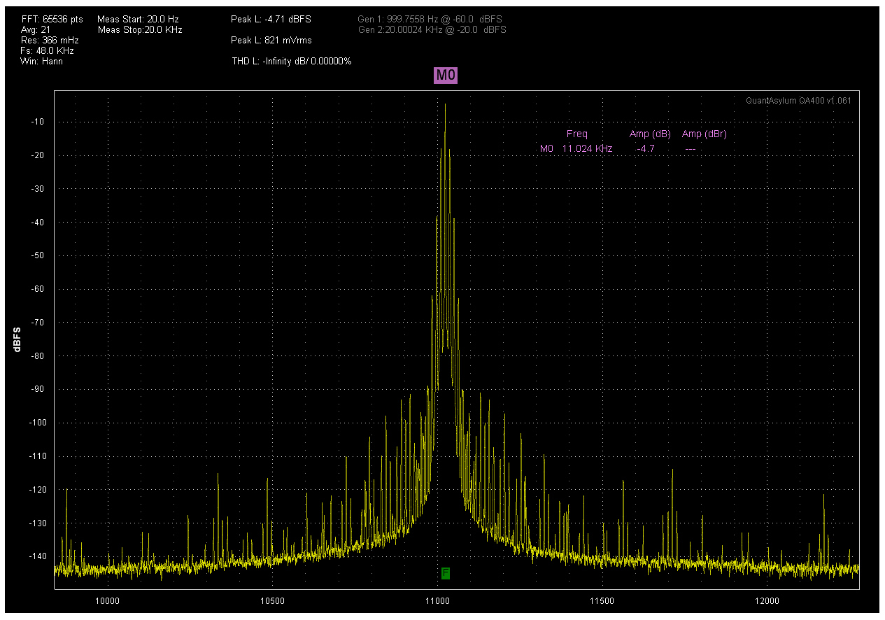

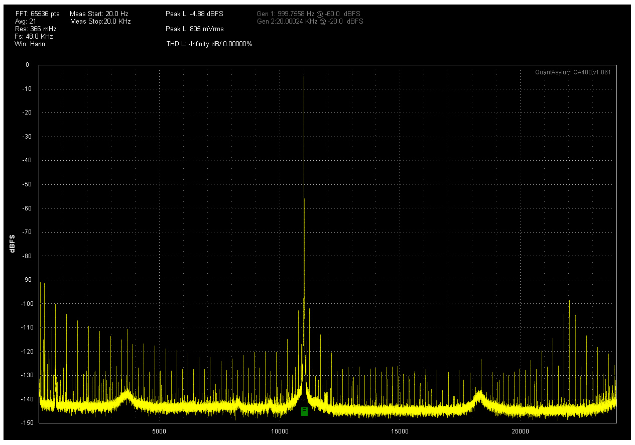

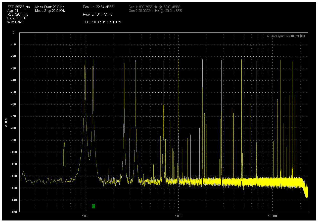

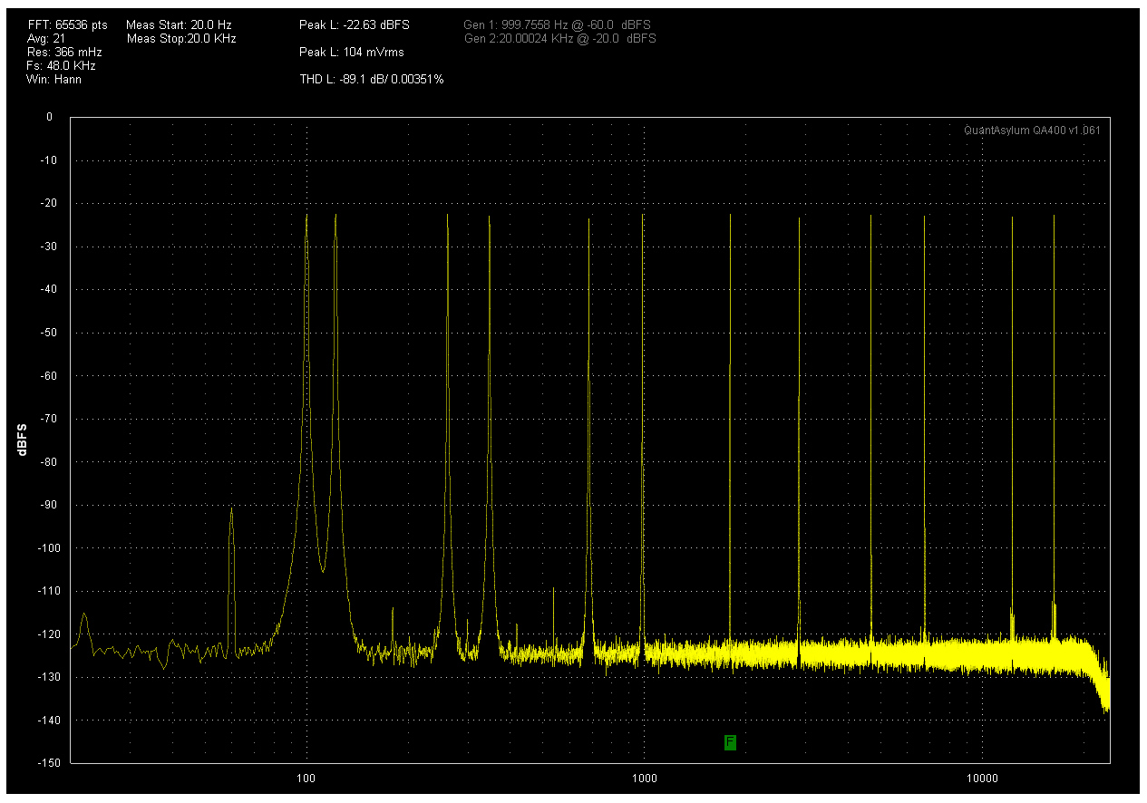

At last 3 pictures of Wakibaki's Jitter3, with the original xtal and with the Marconi modulated oscillator.

That's really interesting because the 'experts' here at DIYAudio, would say none of it is audible. Its all masked as within 2H. Hmmm.
However, I believe you hear what you have shown and reported. And could identify in blind random switch between #1 and #3. Which is what you would have to do to change minds of the self appointed "experts" here.
THx-RNMarsh
THx-RNMarsh
That's cute, because it does more to say that well behaving stuff is inaudible to miklos versus a pretty ugly looking pair of plots I'd assume are quite audible. (Post 6312) Methinks it's worth your while to reread Julian Dunn's work on jitter and the j test.
nah. Not that involved or interested.... unless it leads to something I can do that improves my designs/system. Just poking fun at the nay Sayers who wont listen for themselves yet who say you cant hear this or that.
