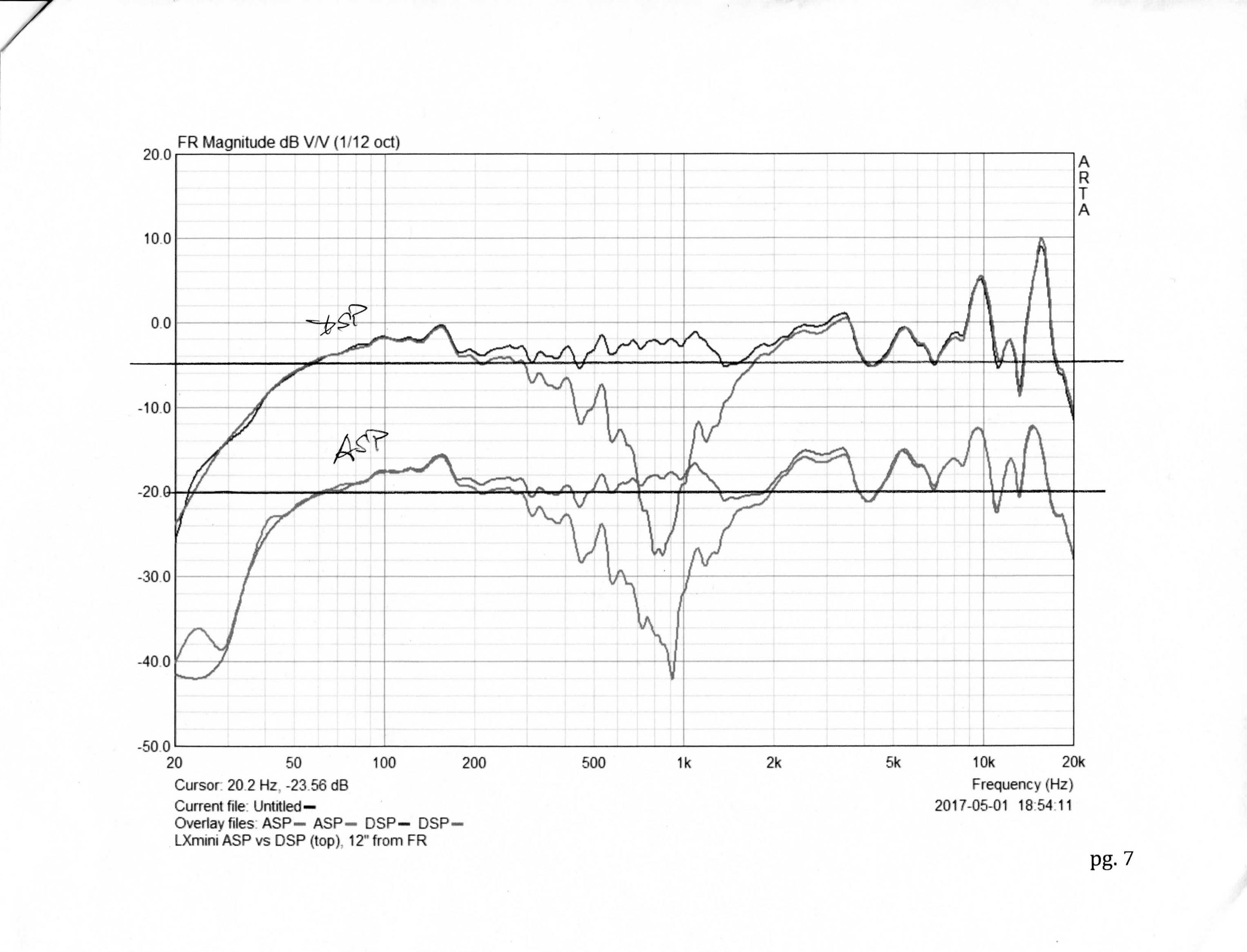

those large peaks that didn't get EQ'ed out are a problem IMO.
Here was the result as measured by SL (It includes the null cases for
crossover analysis). Clearly it was not damaged for lack of EQ on the top.
Some small amount of improvement.
I don't know what dsp was used for EQ but this isn't very good job. Should be flat(er) by a long shot when used for EQ. These are really large peak variations in both cases. 10 and 14dB ! wow. Those two HF peaks are bad news. The decay there must be long due to what are probably resonances.
THx-RNMarsh

Trying to improve the "fiddly bits" is fraught with problems. Just ask Slartibartfast.
I haven't had that experience when I have done it (successfully) using dsp. If those huge peaks shown are called 'fiddly bits'. One could also put a passive LRC notch filter on each to flatten the response.
However, I would never have chosen speakers with that poor behavior in the first place. Sure would be interesting to know what he was thinking when he chose that driver.
THx-RNMarsh
