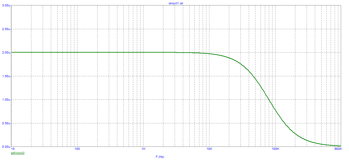

There was a sophisticated debate about GD recently. So what does this specific GD plot tells to me, is it good enough for audio, little, much? ITD concerns?
Seeing as the worst case is 2 uSec, I'd say no, especially if it is in both channels.
Is it single frequency data?
If I were building a really high end system for imaging, I'd be far more concerned with the absolute symmetry of the speakers and the listening room. Electronics would be far down the line. But after reading Lavry, I'd get a DAC that at least does the zero insertion NRZ with a four pole filter. I'd see no reason to go past that. Well, maybe a 96, but no further.

How can-one answer ? As it is added to the group delay of the speakers we listen by ?There was a sophisticated debate about GD recently. So what does this specific GD plot tells to me, is it good enough for audio, little, much? ITD concerns?
Knowing what this is, I’m anxiously waiting for Richards response.
After all he initiated the GD discussion.

Usually measured in millisecondsHow can-one answer ? As it is added to the group delay of the speakers we listen by ?
And its threshold of audibility
Blauert, J. and Laws, P. "Group Delay Distortions in Electroacoustical Systems", Journal of the Acoustical Society of America, Volume 63, Number 5, pp. 1478-1483 (May 1978)
Frequency Threshold of Audibility
8 kHz 2 msec
4 kHz 1.5 msec
2 kHz 1 msec
1 kHz 2 msec
500 Hz 3.2 msec
Some more recent work showed that these thresholds may slightly decrease with the SPL, being always well over 1mS, anyway.

Luckily however, that is not localization. If it were, we as a species would already be dead, as the predators woulda wiped us out.And its threshold of audibility
8 kHz 2 msec
4 kHz 1.5 msec
2 kHz 1 msec
1 kHz 2 msec
500 Hz 3.2 msec
