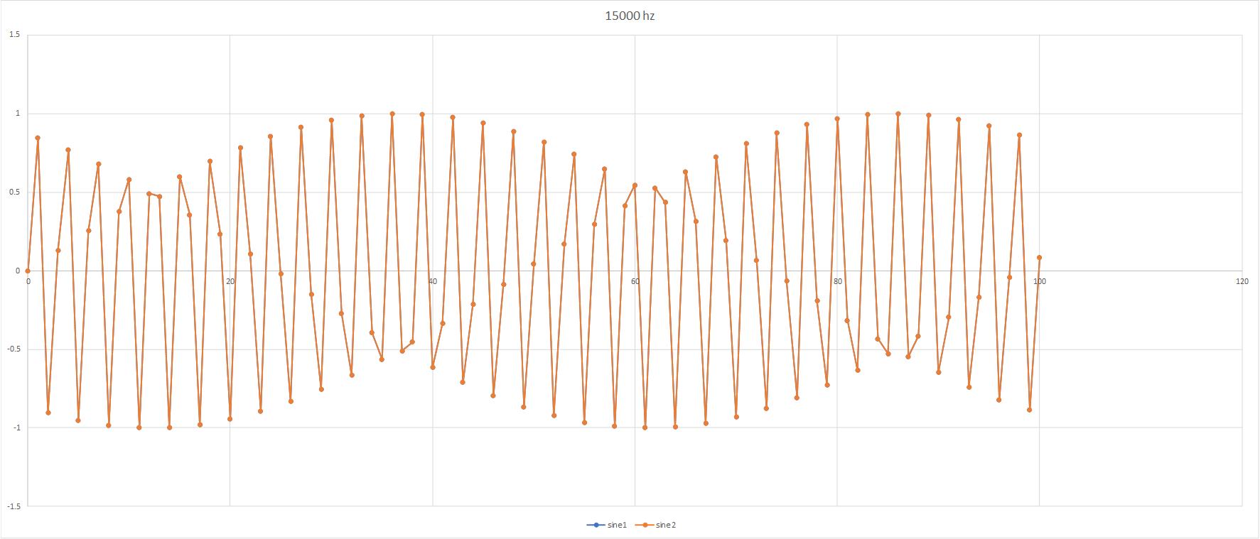

ps...just did a 15k sine sampled at 44.1 This time I used straight lines so it would really be dramatic.. But seriously, I tried it without any lines and the dots look way too confusing. Put it up only because I said I would...
