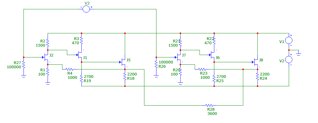

I was thinking that this simple feedback amplifier might work well with differential AD1865 and passive I/V. Based on a borbely article. Simulation says 3rd is -108dB in relation to 1V peak, and the bandwidth (-3dB) is over 4MHz. But the actual performance will be very far from the simulated I believe.
Shown this way because it is easier to understand, but I would prefer a single supply and disconnect the source degen resistors of the input jfets from ground. Reference them to one another. Output will be AC coupled of course. Hope it will be stable with long jfet leads (I don´t want to cut them short, might have to use these jfets for something else at some point).
