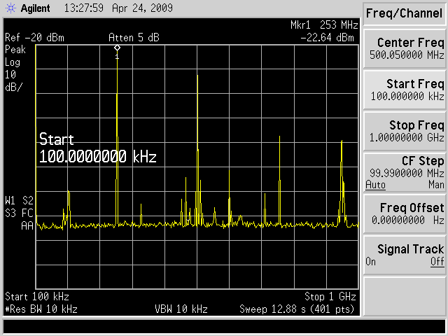

I had similar troubles as described by Damir in one of my very fast (too fast) preamps, switch on or connecting the RCA cable triggered SOMETHING (but say only once from 20 attempts), that I discovered only after I used a GHz spectrum analyzer (attached). 253 MHz oscillations triggered as described. So I agree with Ovidiu. Richard has numerous measuring instruments so they should be used next time, for evaluation and torture tests.
