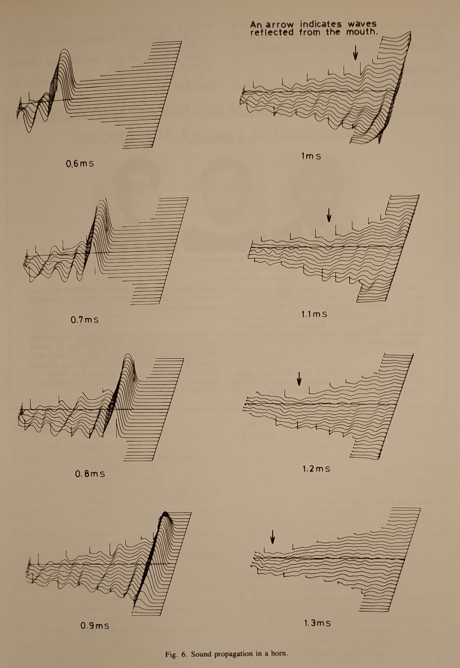

Horns have quite a few challenges, one of them is the impedance mismatch between diaphragm/phase plug/throat/mouth, causing multiple reflexions before the sound wave hits free air. I've previously mentioned an AES paper by JVC, here's the relevant page in the "Loudspeakers - An Anthology".
The presentation was even more spectacular thanks to the video, but I'm afraid the tape is lost forever.
