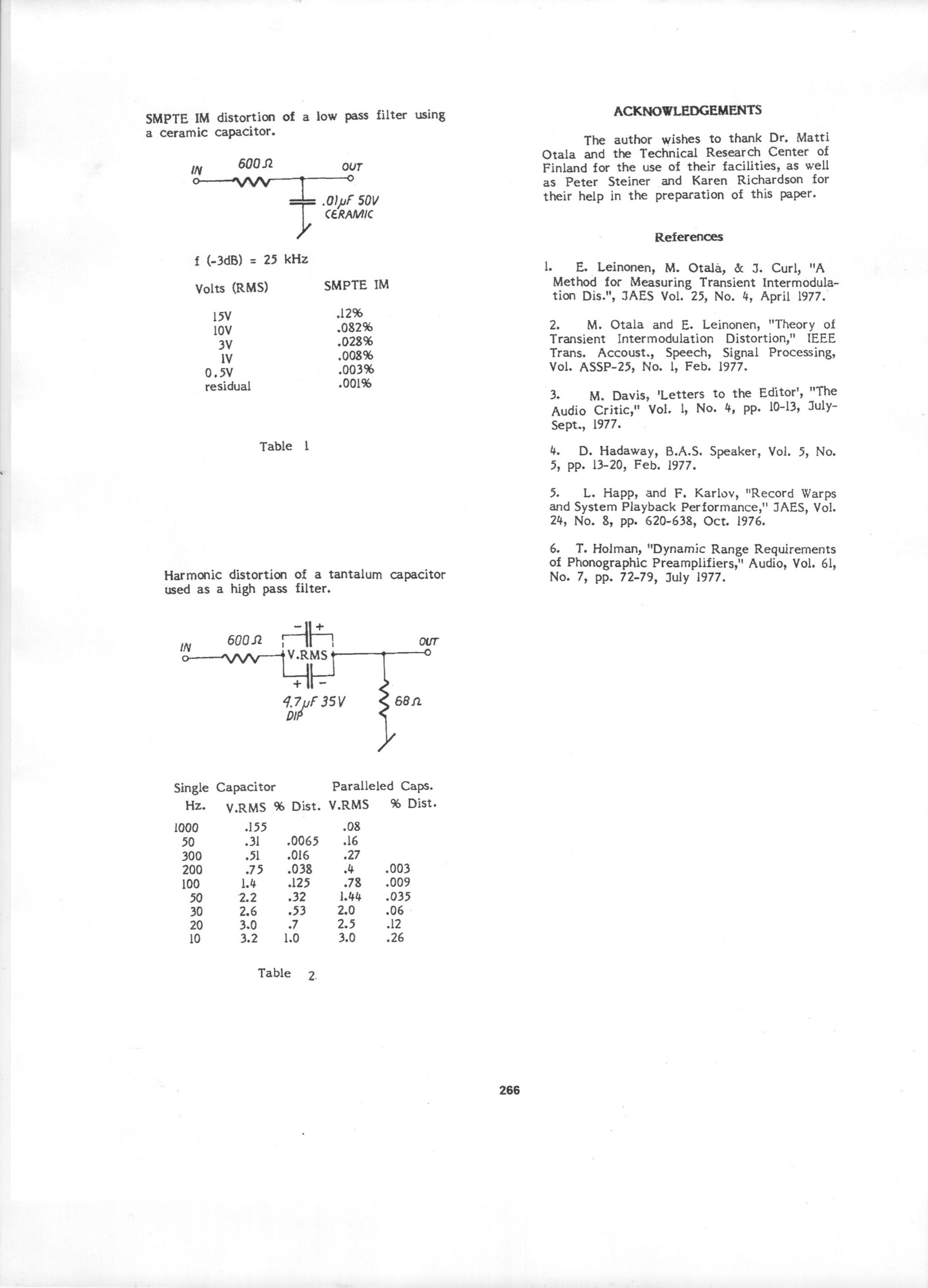

Cyril Bateman demonstrated that there is a high correlation between dielectric absorption (and voltage across the caps) and harmonic distorsion.
For exemple, he found the ceramic COG caps are among the best for low harmonic distortion. Samuel Groner confirmed how good and reliable they are :

DA is almost entirely a LINEAR distortion, rather than a NON-LINEAR distortion as measured by harmonic or IM analysis. That is why it takes unusual test procedures to measure it adequately. A single sine wave will not do it. It usually takes an unsymmetrical pulse like waveform to bring it out and compare different caps to what you measure with a 'reference' cap like a Teflon or polystyrene cap. By the way, for most practical purposes either can be used for a 'reference' cap.
Richard Marsh first showed this back in the late 70's. Walt Jung and I, (and even Scott Wurcer) used a different test procedure, but we got measurable results in the mid-80's.
Walt, Richard, and I have never looked at a typical audio cap the same way again. It is just too obvious with a useful test set-up, to go back to Mylar or other even less performing caps, after comparing the results.
Non-linearity is a separate measurement, and can be awful with most ceramics,(especially higher value), and Tantalum caps. Less so with aluminum electrolytics, but the DA of aluminum electrolytics is very high, and therefore we tend to eliminate them and use servos instead for coupling between stages.

What yo described is as far as I have come to understand the DA issue, I was just thinking there's some non-linear phenomenon going on when a signal approaches 0 voltage level, perhaps not necessary a DA related one then, but I was still thinking and wondering whether there's still some kind of non-linear anomaly going on which increases with decreased signal level.

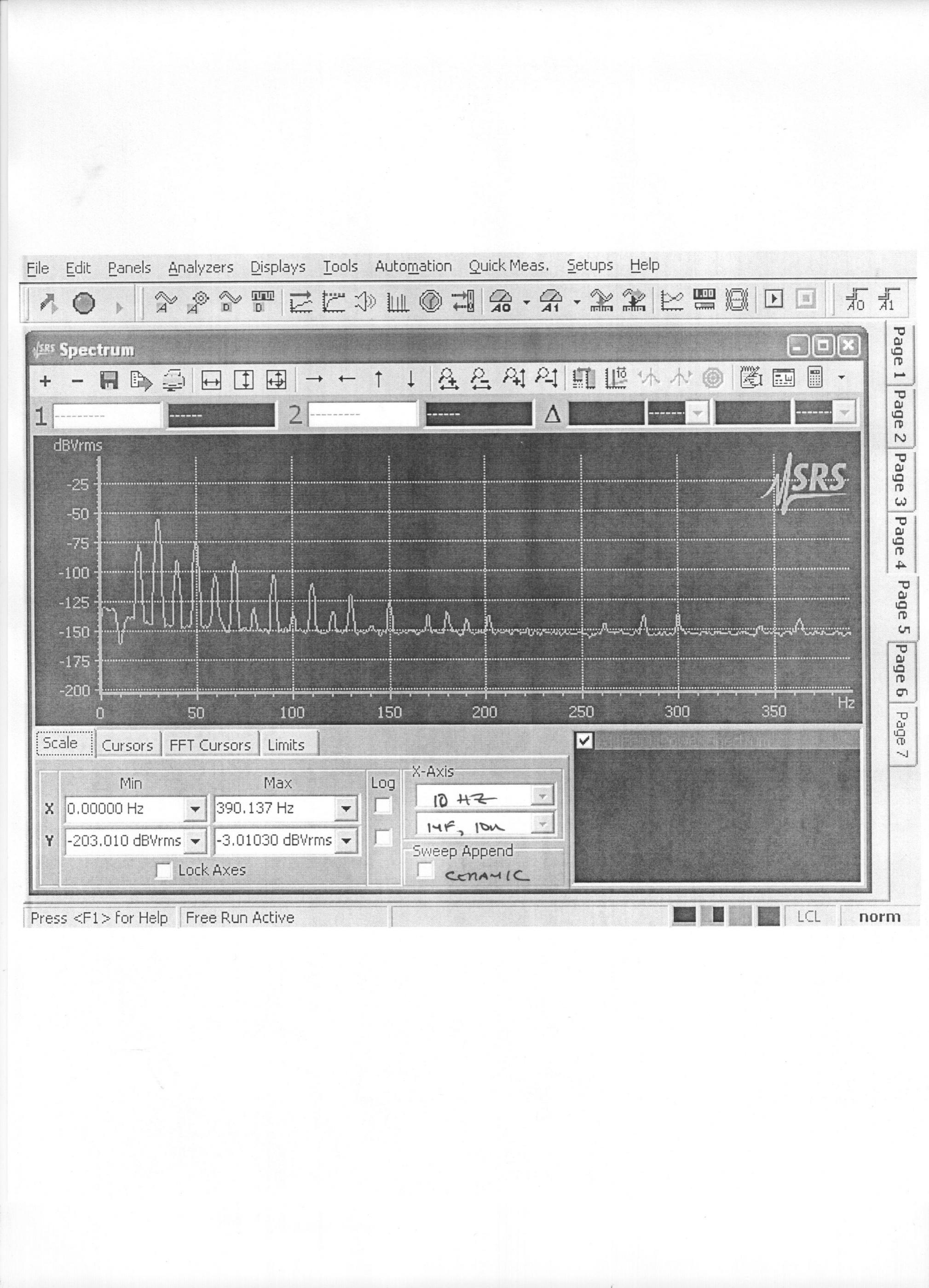

Looking at the first attachment, one could conclude that is certainly not the case for ceramics whose IMD in opposite does instead increase with increased signal level which perhaps not surprising due to the Piezo effect, also very dependent on what type of ceramic dielectrics are used.
The Tantalum appears to also increase in IMD with increased signal level (second column pair), if that is the trend for other dielectric materials as well, then could one interpolate from that, the IMD could also be decreased by choosing a capacitor with as high breakdown voltage as possible for a given signal level.
