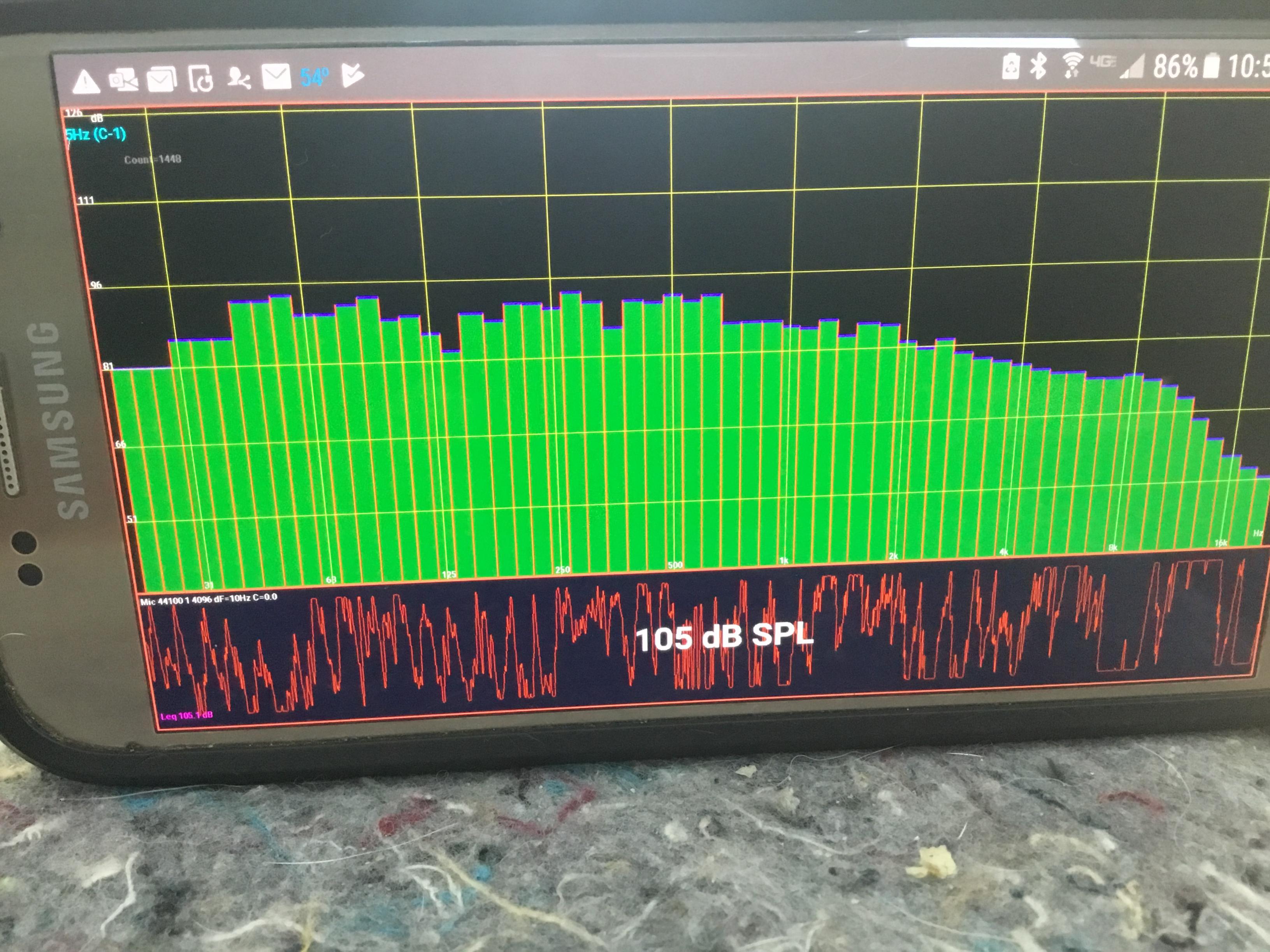

TT ,
This is where my setup ends up in room @ LP , one of my test tracks averaged over the complete track.
I’ve posted this before and people commented “your tweeter is unplugged” !
But there is no lack of treble I assure you......this where it sounds most natural.
To get this avg db there are peaks 112db+ at LP.....this will let you know what a recording is made of!

Your approach seems right to me.TT ,
That makes all the difference between people that fear their ears with some culture that make them understand what they hear, and people that "believe" exclusively in measurements. That i did first, wanting a response curve up to 40000Hz.
My tweeter is really unplugged, now. On purpose. I first thought it was because my age, so I asked young musicians to confirm. They did.
Many good speaker manufacturers know-it as well. But it is not as good for the sales than a flat curve.
And i'm not sure most "audiophile" like a transparent system, but, rather, an impressive one.

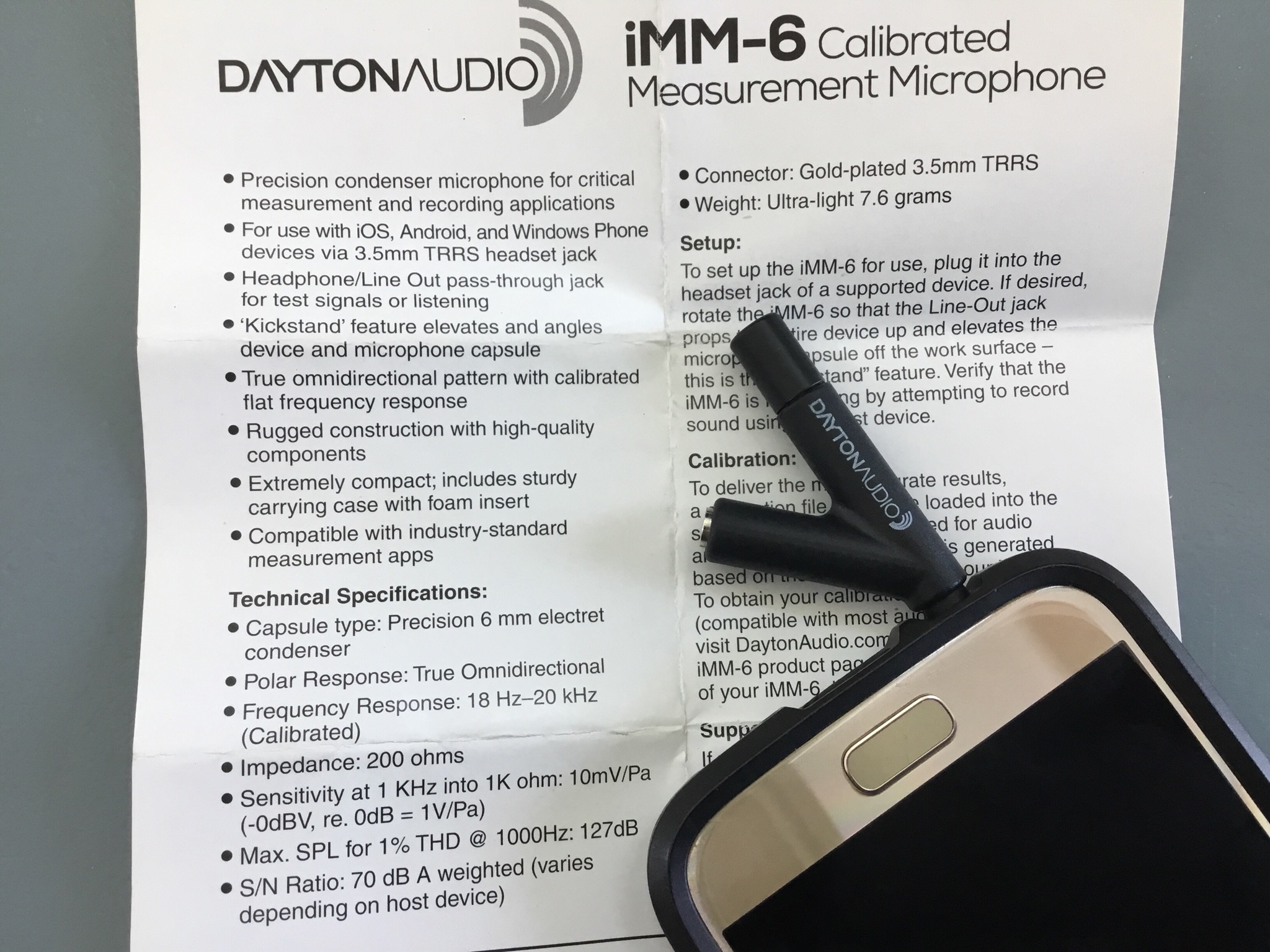

I don’t know but hav3 to ask, this app obviously assumes that the mobile mic response has been calibrated or do you have to cal it in some way?
It’s a Dayton imm-6, they have a calibration file i downloaded.
It’s probably not precisely accurate but it’s good enough for quick comparisons.
My next step is going to be into Dirac (or similar) with a good mic and graphic charting, but for the money the imm-6 is a cool little tool.

Got it - thanks

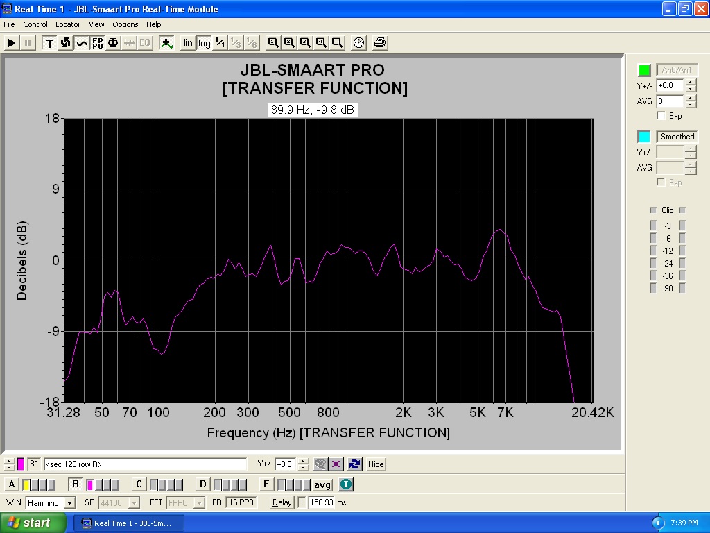

This is one of many readings I took of an NFL stadium 70,000 + seating capacity. (Actually one of the worst seats in the place!)
Note the effect of the sunscreen on the response, particularly the diaphragmatic absorption peaking at 100 hertz.
The air losses of course are enormous at high frequencies, approaching 20 dB at 100 feet. But only 3 dB down at 10,000 hertz, quite good for a venue this size.
