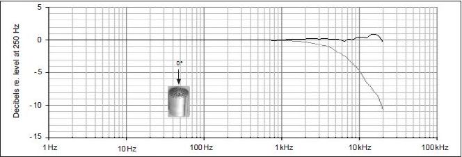

Recording your own live sounds is also a good way to judge your gear... You were there and so you know what it should sound like. Not unlike the process I described for in-home audio eval for accuracy.
Its what is behind my process, i did my own recording ... Revox 30 ips half track set up for using Ampex 456 Grand Master tape. Condenser mics... best sound I ever heard played right off your master tape. I would put it thru an inverse RIAA filter and run it thru the phono stage to listen for its' sonic accuracy. But need to be near-field or the room will distort the sound from what it was at the recording site.
recording in the same space/room as the playback makes it easier to know... dont have to try and remember the sound when recorded. Can do A - B comparisons in near real time.
Just get a great Omni... measurement mic of high quality. Record close to mic... not on top of it, just close... a few inches. No room pick-up. Your ears will do the rest.
THx-RNMarsh
