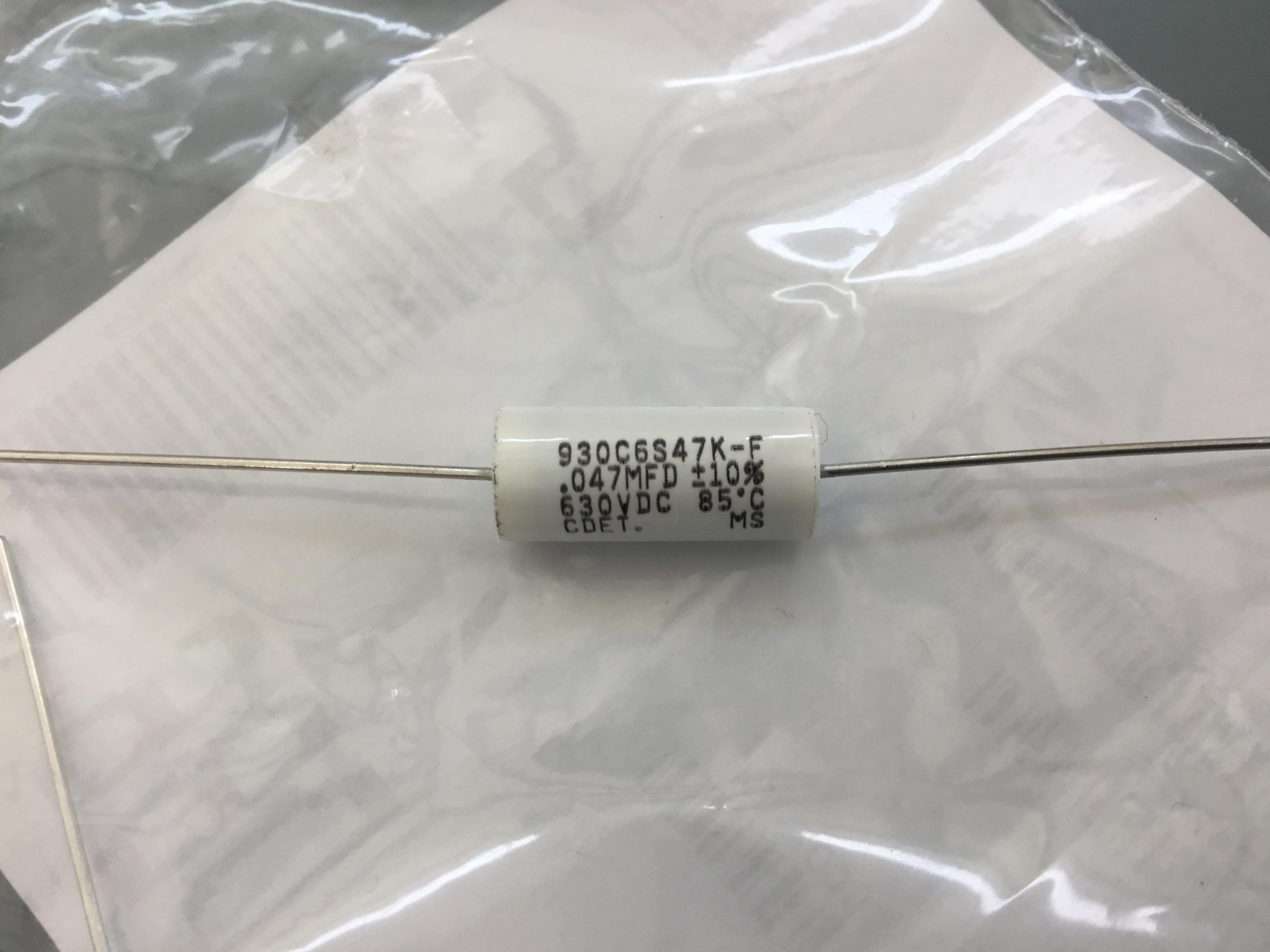

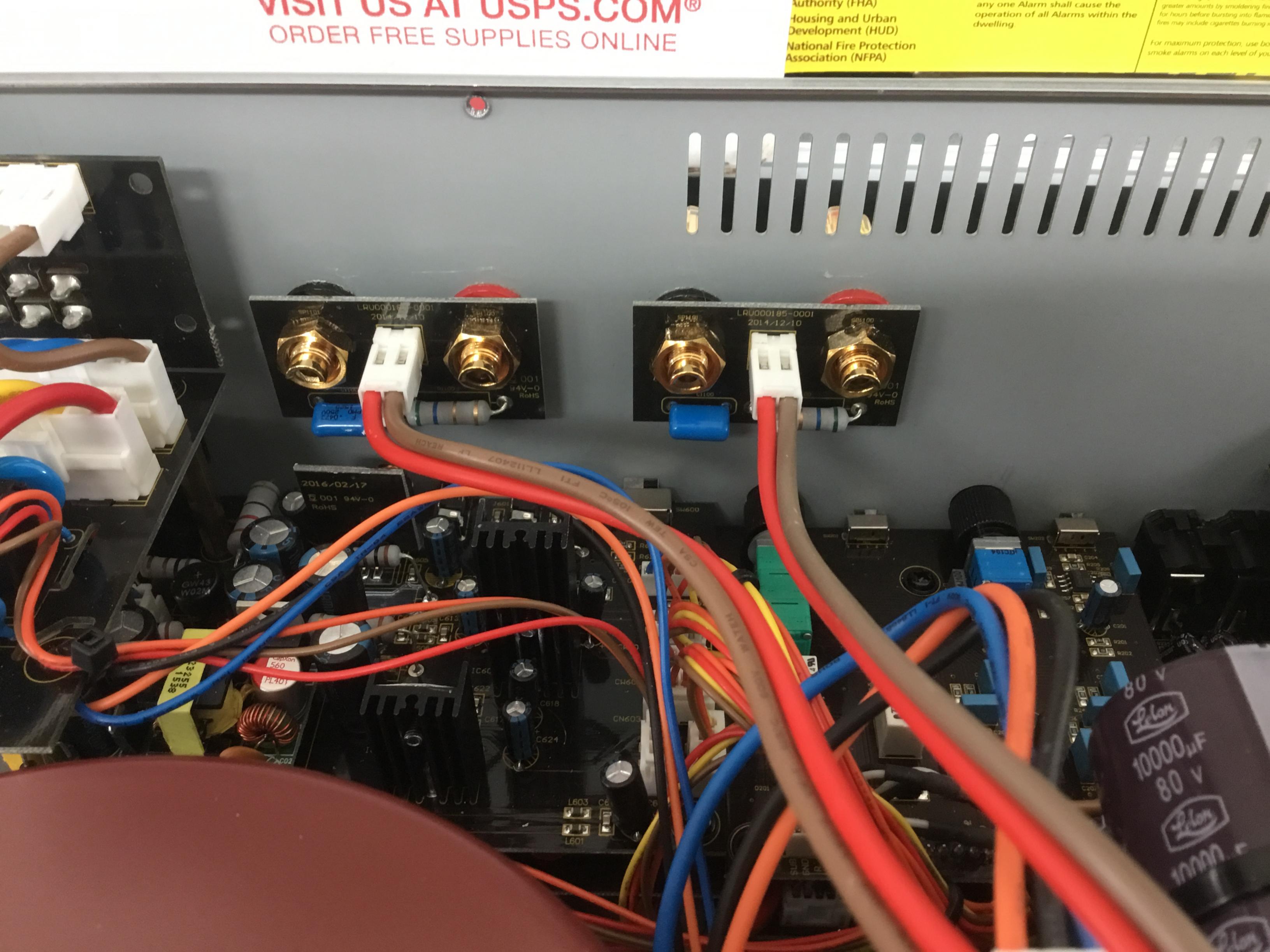

The latest integrated uses a pretty good cap for the Zobel network (metalized polypropylene). I don't know about the earlier one. Pure (non-metalized) polypropylene or polystyrene would be absolutely the best.
This is what’s in the earlier model... polyester?
I picked up some Cornell Dubilier 930C (pp) of the same value to try.....still trying to find a better mf resistor than the mox they used.
