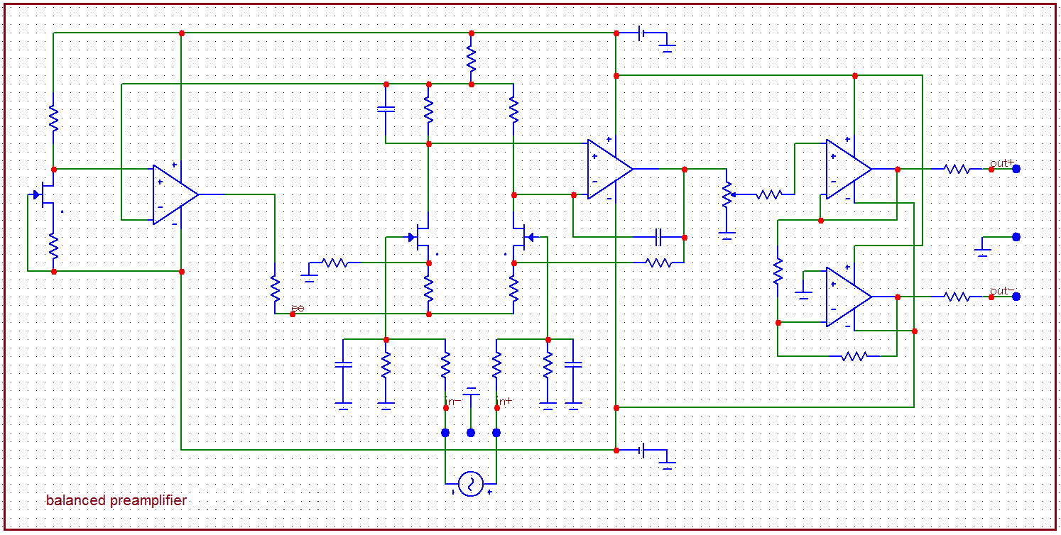

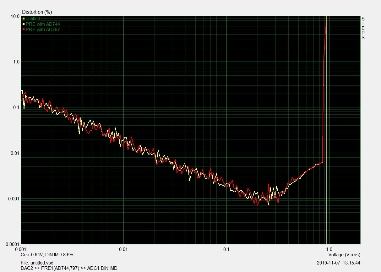

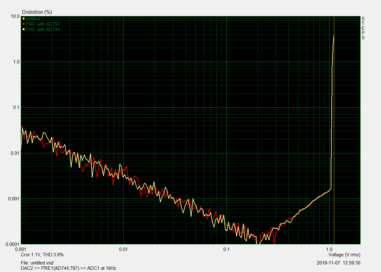

Anyone has any link or measurement that would show that AD797 has issues with HF CMV when driven from DAC output? Just this afternoon I measured the preamp with balanced input driven from balanced DAC output. The preamp has 2x2SK170BL followed by the opamp - AD797. The circuit is in fact the one posted by Scott W here a few years ago (thank you Scott). I measured THD and DIN IMD vs. level, covering almost full input range. Output is scaled by the stepped attenuator to match ADC input max. level. I can see neither THD, nor IMD "hump" as seen in
ESS THD ‘Hump’ Investigation | Audio Science Review (ASR) Forum
and I doubt the opamp is the reason of the hump.
Swapping AD797 for AD744 gives almost identical overlapping plots, that are completely determined by DAC/ADC parameters. Not by those of the opamps in the preamp. I think that once again some fairy tales are created here, that would be certainly appreciated as "open minded" by some members 😉. Without any proof, as almost always.
P.S.: my measurements show flat 80dB CMR within 20Hz-20kHz with this preamp, without special selection of resistors, just took 1% metal film types from the same batch.

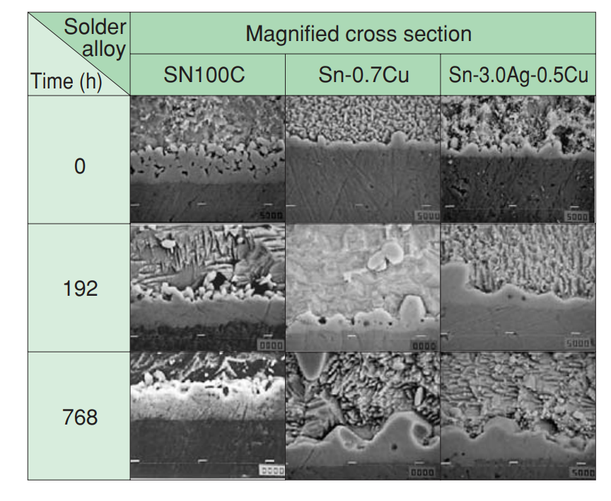

Thats looks like silver free Hihon Superior SN100c
●The trace addition of Ni means fewer shorts and no shrinkage defects
●Ni-stabilised intermetallic layer inhibits copper erosion
●Reliable in harsh environments
●High ductility ensure long service life of joints subjected to cyclic strain
●SN100C is formulated for minimal generation of dross.
Effect of Germanium on secondary lead-free tin solders
germanium in lead-free solders reduces the formation of oxides on the surface by the addition of 0.01 wt. % Ge to the batch. With the amount of 0.01 wt. % also the grain is refined in the microstructure, resulting in improved castability. In terms of solderability experiments confirmed that germanium improves the flowability of solder on the PCB substrate
