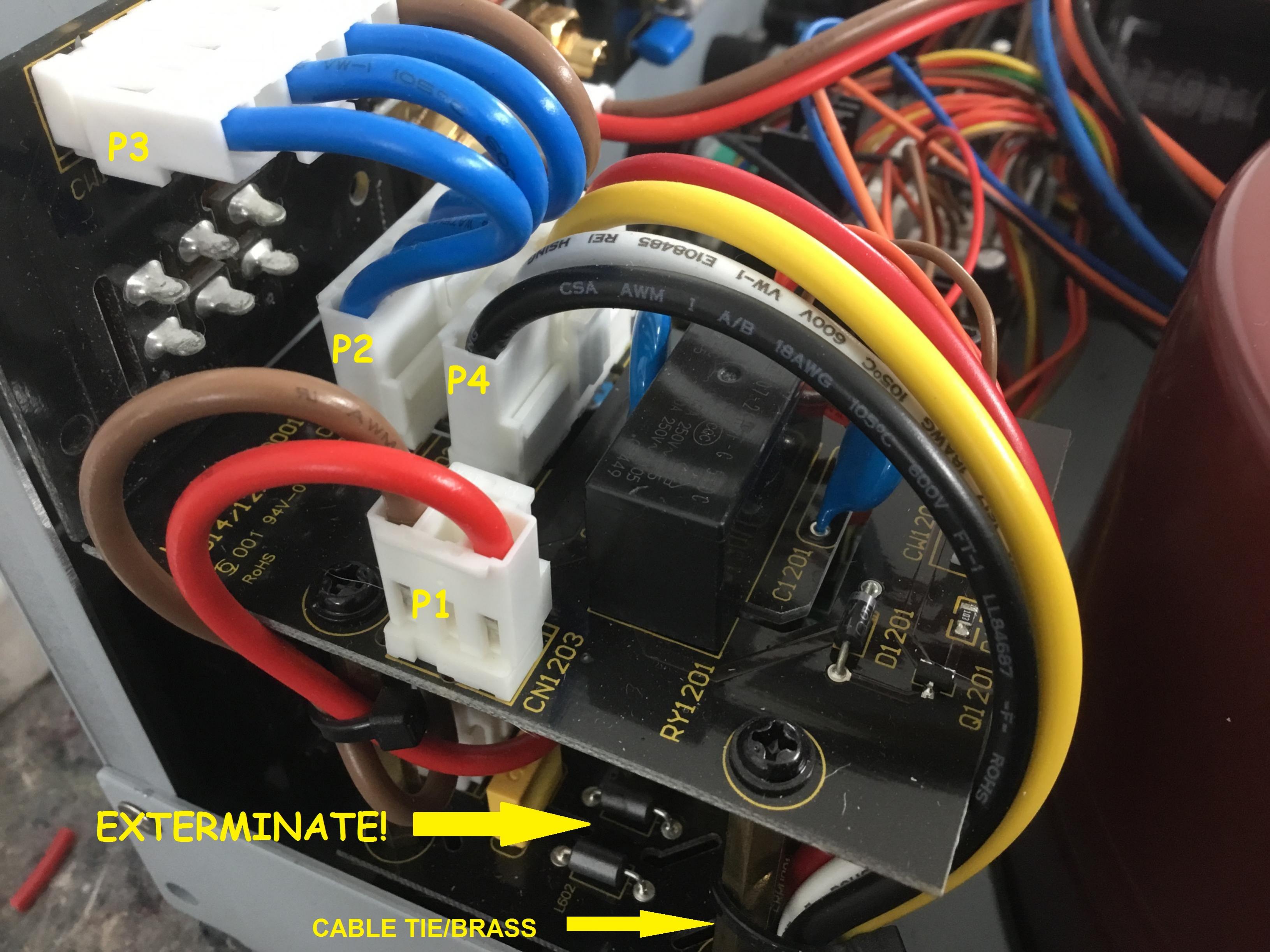

I suppose it would prudent to understand why the little ferrites are there before removing them and replacing with twisted wire and if that would cause detrimental effects somewhere else.

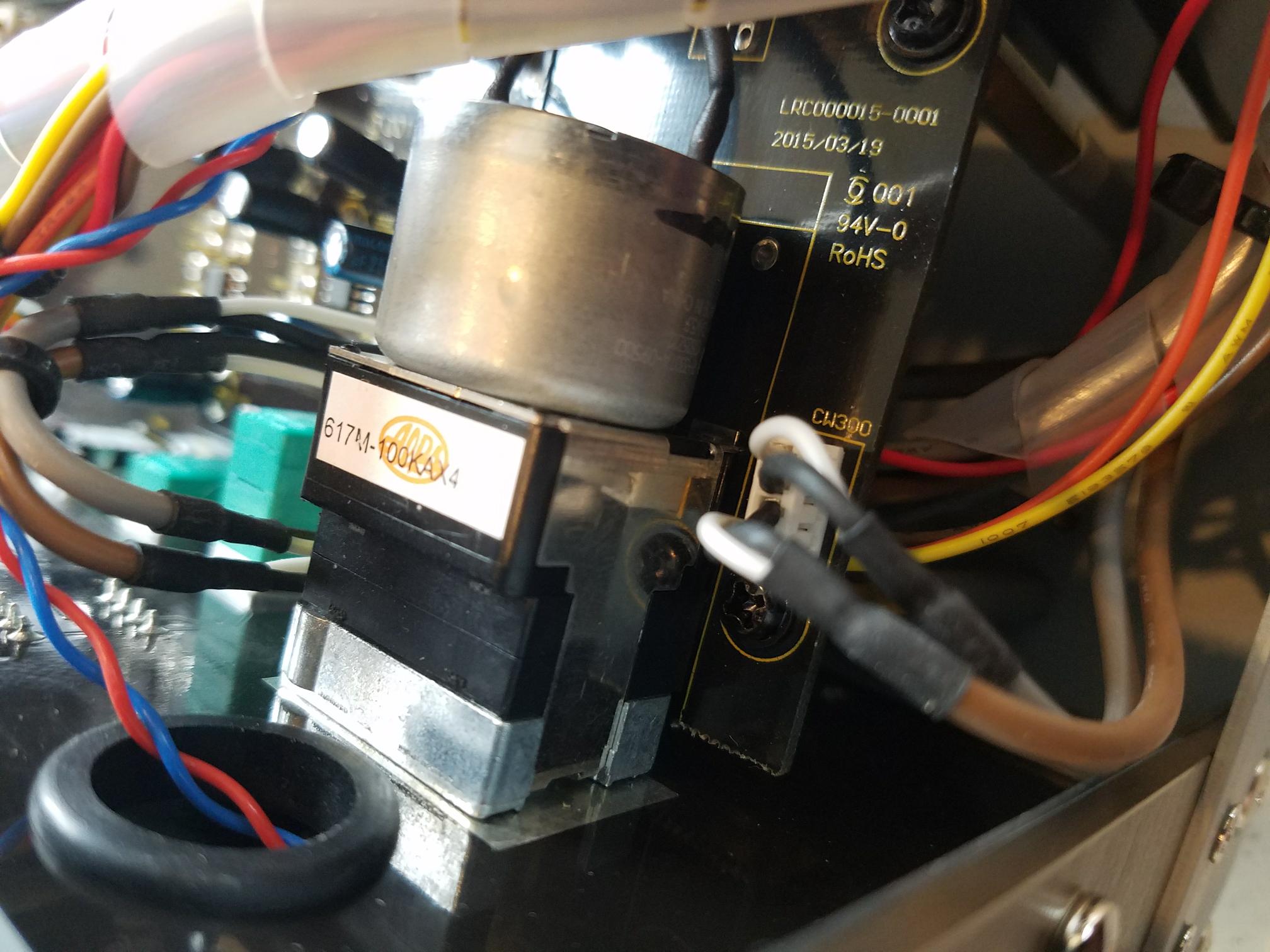

Alps .....don’t know if it’s a good one though? It’s analog....the Hint 6 got the new burr brown resistor pot but it works in the analog domain also.
Oops, Alps indeed.
I was talking about the amp that PMA posted the picture of.
https://www.parasound.com/product-images/hint6_black_inside.jpg
I didn't see any Alps there. And yes, that BB part is what I had in mind. I should have said 'digitally controlled volume control' instead of 'digital volume control'. Anyway, in my book that part is a no-no.
