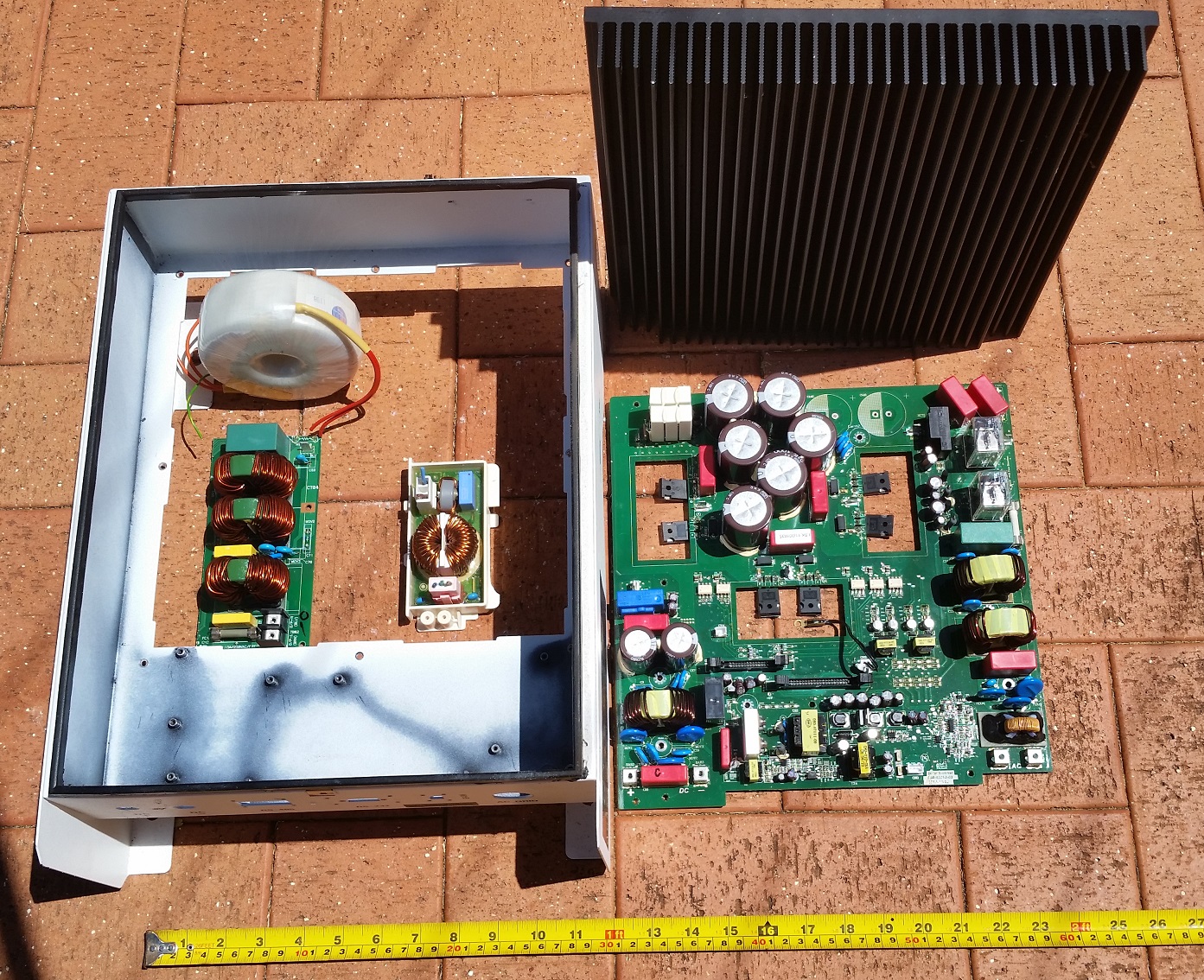

My current project.....power isolation filtering box built from free e-waste.

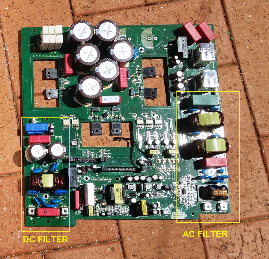

Pic 01, the donor machine, a scrapped grid tied solar inverter with two robust filter/protection stages, one AC, one DC and mega series inductors.
Pic 02 shows the heatsink, very suitable for building a serious amp.
The HS has a groove milled around the perimeter with o-ring....note to audio constructors.
On the left is shown screened isolation transformer rated 225VA (I have four) and two AC filter stages, one hacksawed from another solar inverter PCB and the other from a washing machine.

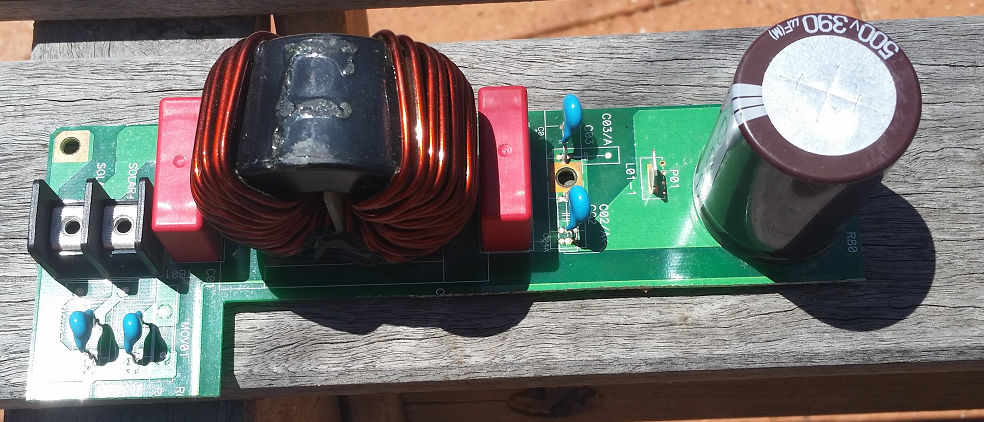

Pic 03 shows filter sections of donor board ready to be culled with a hacksaw should I decide to use them.
The result will be 240V power conditioner box with filter/iso transformer/filter feed to laptop ext psu and filtered feed to amp/sub.
I already have a DC Filter culled from another Solar Inverter in series between laptop ext PSU output and laptop DC input plug...this has provided calming/clearing of system sound.

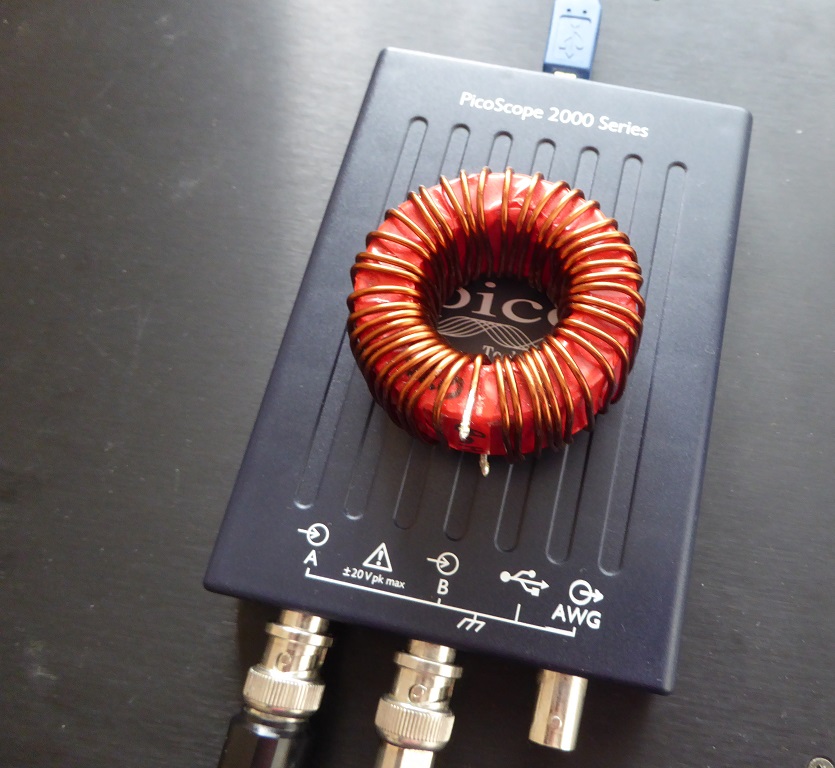

Hi Dan,
interesting project. My experience with similar inductors for this purpose (big toroidal ferrite core) was not very good - it saturated early. Of course it depends on core material and number of turns. My inductor is in the photo below.

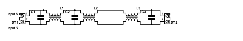

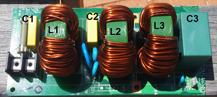

Ok, both the filter sections on the solar inverter pcb are CM filters, one section is solar panel DC input CM filter, with polarised electro cap across output of the filter section....this polarised cap could be removed or replaced with film cap for AC usage.Max, any idea what is inside those inductors in the AC and DC filters?
I already have this filter in series with the DC supply to my laptop and have found it to be an improvement.

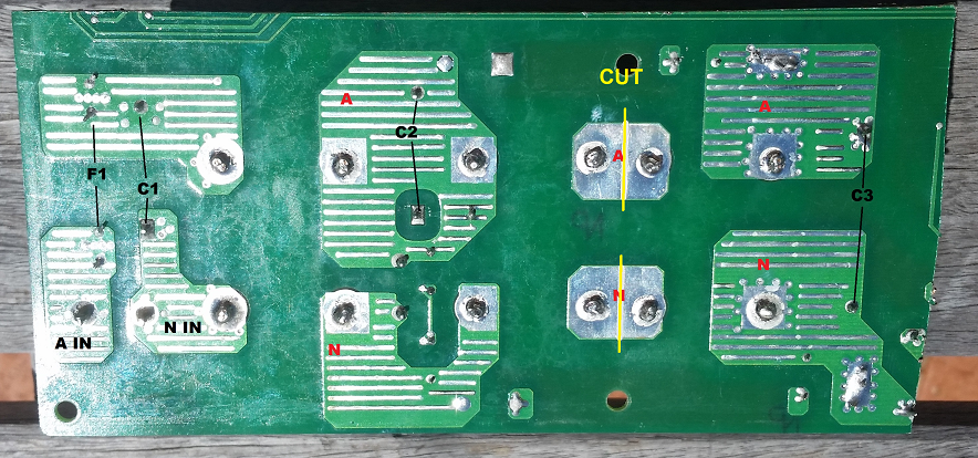

My interest is more on this AC filter pcb which can be modified easily by cutting two pads and inserting an isolation transformer.
I intend cutting the pads connecting L2 and L3 and wiring in a screened torroidal isolation transformer.
This isolation/filtering section is to power the laptop only.
I will cull the AC section that is on the large pcb shown in my earlier post and use it to filter the second AC output of this power conditioning box with the second circuit powering the amp and sub only.
Questions to experts, should I put caps or RC networks across the iso transformer primary and secondaries, IOW across output side of L2 and input side of L3.
Currently fitted C1 - 0.22uF, C2 - 0.33uF, C3 - 3.3uF.
Dan.
