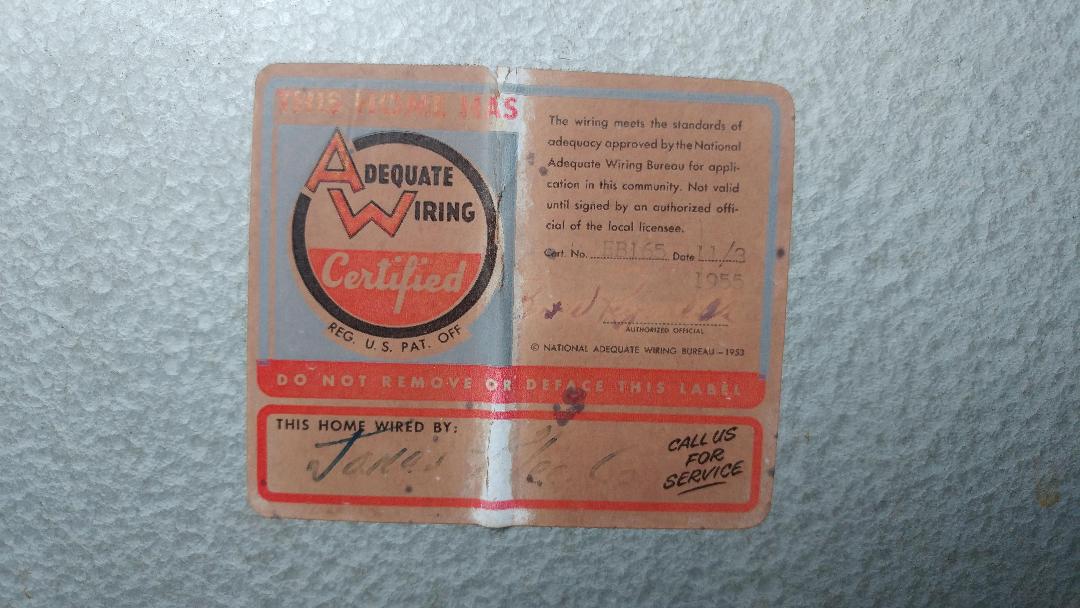

My house built in 1955 went the other way with 32 breakers and BX throughout. There is a sticker on the primary panel certifying "adequate wiring". They really needed better marketing. . .
