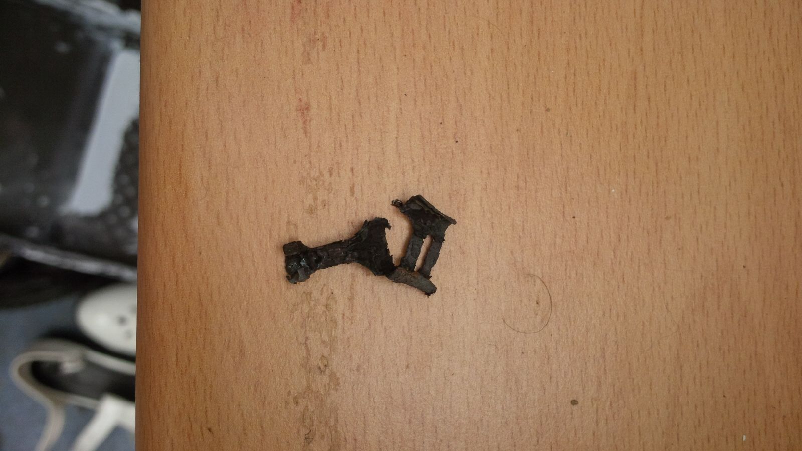

why I am not fond of dryers and distrust certain types of crimp connections in high current applications. That was the neutral connection from the heating element on my dryer. Or at least what was left of it.
Those connections now get a regular inspection.

As I was prepping the new 4 wire outlet, I reviewed the three wire one. At first, I was confused...(yah, ok I know I'm setting myself up here).
The old 3 wire was a 10-2 conductor, the bare copper was used for neutral, white and black were both hots. So, the wire I was mis-posting as neutral was in fact a hot leg.
The reason it burned was that the terminal was not tight enough, that much is clear.
Despite that error, the discussion of keeping neutral and safety bond separate is still totally valid.
