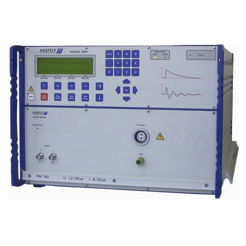

We bought and used a HV gen like this for simulation testing to pass the UL1449 and other specs/ tests.
rent-haefely-pim-100-combination-wave-impulse-module-for-iec-61000-4-5-and-ansi-c6241.jpg
No guessing if the protection was adequate or not.

Yes lightning surge 1.2/50us voltage wave and 8/20us impulse current wave. Good to test a product, but not to test household wiring, especially not to confirm insertion of inductance into N or PE household wire - both is prohibited.
??? Huh? UL1449 is not a household testing spec.
It does allow me to know how much Ls is needed to reduce amplitude of peak impulse voltage before going to MOV; Extending the life of the MOV and reducing the likely-hood of MOV short/failure.

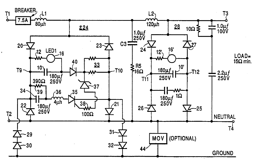

It might be time for me to once again share my enthusiasm about the series mode surge protectors sold by ZeroSurge (website). Their circuit design installs an inductor in series between the AC mains and the protected equipment, which slows the dV/dt and gives plenty of time for the surge clamper (monstrously large SCR) to turn on, so your downstream equipment does not see a fast risetime impulse. It's covered in a series of US Patents, the first of which is 4,870,528 attached below.
Circuit component "L1" is the series inductor and circuit component "35" is the monstrous SCR. I own three of these surge protectors, and am quite pleased with them.

The real weakness is the lack of common mode surge suppression. Also the L/C approach mostly spreads the surge. The SCR will absorb some surge and then pop the breaker.
I my experience the best solution is a purpose designed transformer for isolation and surge suppression. The transformer works as a bandpass filter and saturates on surges. However its large, heavy and expensive to implement. (Wait, High End Audio- how perfect. . .) E.G. Isolator Series 120V 1000W UL60601 1 Medical Grade Isolation Transformer 4 Hospital Grade Outlets (IS1000HG) | Tripp Lite Its not a normal isolation transformer. Tripplite seems to have bought this line of products from the older vendor PMI.
Are you talking about an event which displaces all three wires (line, neutral, ground) in the same direction, by the same large (thousands of volts) amount? One point along the ground wire is connected to The Earth itself, so that little beauty will carry a helll of a current.
