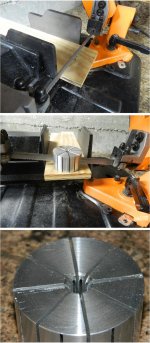

How did you get the super thin metal on the sides? Bandsaw? Slitting saw? Sheet metal and glue?
Here are pics of the setup.
The pin on plywood, how the saw cuts, and a detailed look at the end showing how much aluminum is left at the center.

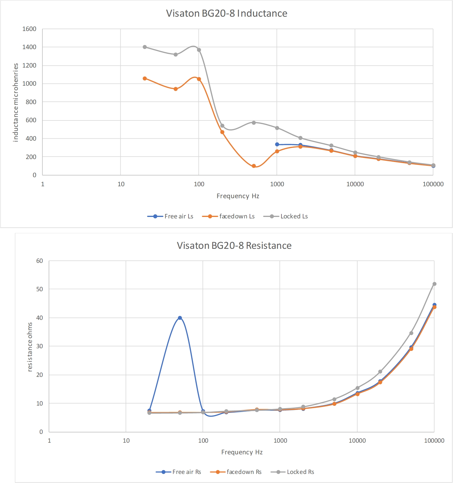

Here is the first pass measurements of the visaton BG20-8.
Inductance full scan:
On the first, the free air numbers go bonkers below 1K, wildly swinging from -77 mH to +10 mH.. so I didn't put them in to preserve scaling.
Note the facedown (orange) is reasonably behaved. To lock the cone (grey), I placed the woofer face down on a plastic electrical tape container. I think it was touching the cone, but it may have been touching the whizzer. So it's not very well locked, but it's all I had at the location to use.
The higher inductances "locked" are probably due to the fact that I had the cone pushed into the gap a bit, so this should be the expected Le(x) rise with position.
I will still go better on the locking before I disassemble the speaker. I suspect it will go monotonic slope when I hold it very tightly.
Resistance:
Free air resonance is very clear, but I did not do a tighter zoom there, so 50Hz is not the resonance, just the closest to it. Note also that the "locked" resistance from 2Khz up is leaving the free and facedown numbers. Something is causing extra hf dissipation as the voice coil moves into the magnet structure.
The second is a zoom in on the 20 to 160 Hz "locked" readings. I suspect there are cone vibes involved messing the readings.. But you had asked, so I gave it a shot.
I will be making the proper fixture for locking the cone and positioning it to various locations.

I already explained it a while back. The phase crosses through zero but the meter is designed to report exactly what it sees and does not take the absolute value. It does not understand that this is a mechanical energy storage/return. Some meters will do the absolute thing.
As to source Z, who knows. It's an HP 4284A.
For these scans, the really important stuff is the dissipative hf loss as shown by increasing resistance, and the change in hf dissipative loss when the voice coil is moved in the gap.

The HP is for passive components. The hysteresis of the iron has its influence. The HP is not immune to multiple signals (back emf). And, resonance are areas you need to see what is happening there also. The largest effect on reducing THD with a wide band current-feedback signal showed only below 100Hz had the largest reduction.
Granted, I never checked above 1 KHz.
Is the coil under hung or over hung? Heating effects on R vs coil location....?

A speaker is a passive component...
I use this meter to test everything from 100uH air coils to 28 ton iron dominated magnets to 70 Henry solenoids. The meter has no problem with any of those, so no to the hysteresis.
The meter does have problems if the inter winding capacitance causes a resonance. But I do the frequency scans precisely for that reason. I want to know that the frequencies of interest are well behaved measurement wise. By going a decade or two in either direction, the system stability is easily assessed.
Don't know if it's over or under. I bought it because it was a 30 dollar full range. Visaton BG20-8, you can google the specs.
No heating, the meter doesn't drive that hard.
Jn
yes, I believe the meter would have issues at resonance. The difference between this motor is a moving coil assembly. Your examples are fixed, I believe. The back emf is velocity related, so a high Q resonance from a moving coil motor/speaker will generate a large back EMF.

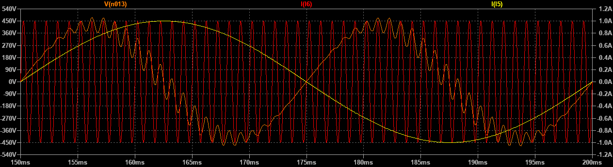

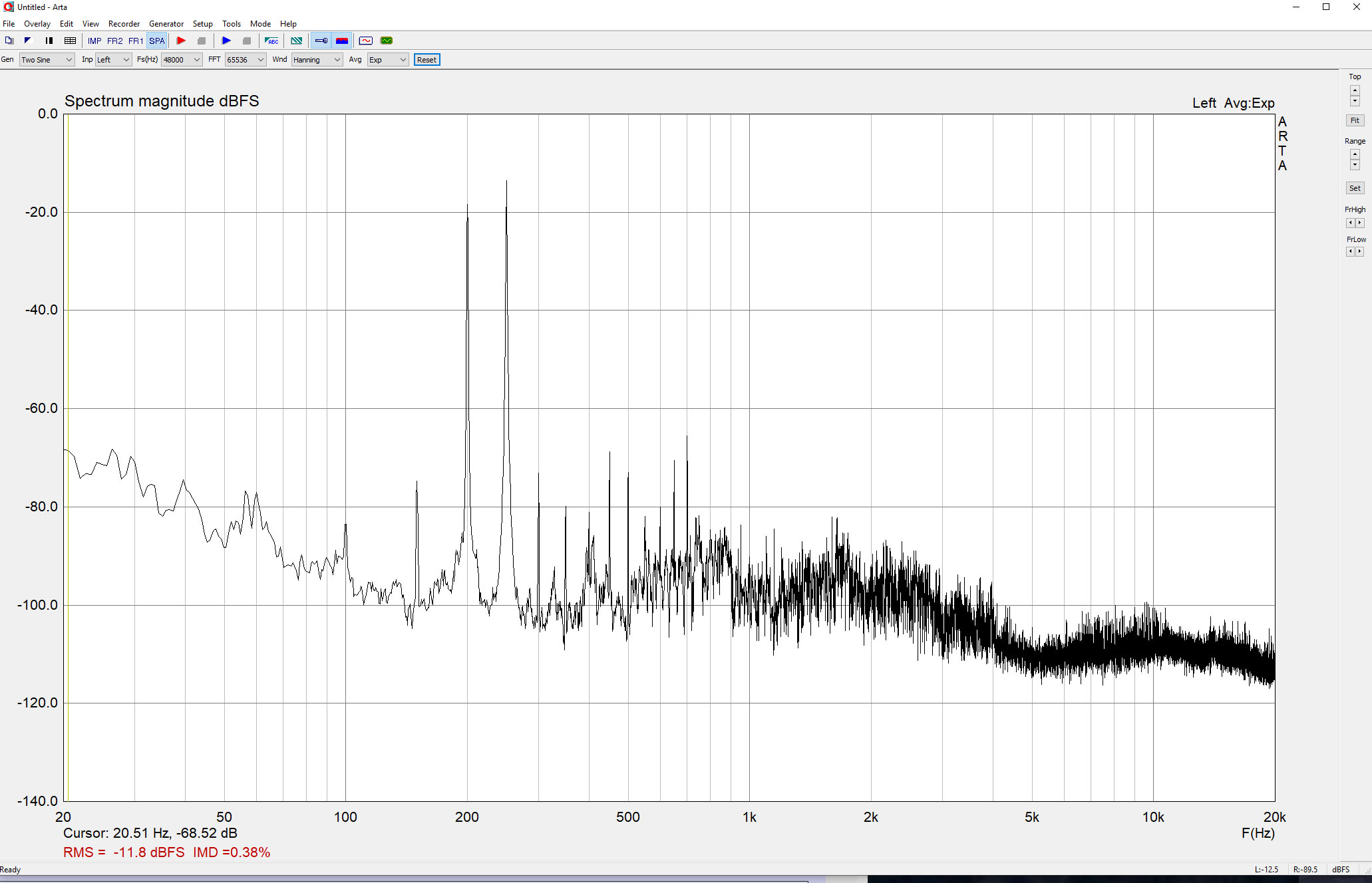

Interesting. For comparison, IMD measurements of a new speaker design I am about to finish. Measured in noisy environment, going to book anechoic room shortly for fine tuning and proper measurements. So far, so good.
No 50Hz tone? Are you using a special magnet structure or do you cancel it out somehow?
Still can't figure out how to generate dominant 3rd harmonics magnetically in a tweeter. Everyone talks about it as if it's obvious, I suspect they have never tried to model it themselves.
jneutron, is this the eddy current variable damping you were talking about?

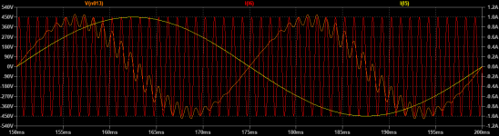

Yellow trace is the voicecoil current.
Red trace is voicecoil motion.
Orange trace is the magnetic force opposing the motion of the coil.
I'm trying to understand the waveforms. You added hf and LF, the orange is drag on vc due to LF position?

The red trace is coil velocity. The orange trace is the force of the eddy current opposing it in the direction of travel. The coil is electrically driven with 20Hz and is mechanically vibrated at 1KHz. The eddy current force opposes the 1KHz vibration which shows mechanical resistance. The 40Hz wave in the eddy force is a result of the coil current changing polarity and thus the polarity of the flux acting on the eddy current to produce force. If the eddy current weren't phase shifted 90 degrees then this would have a DC component. Eddy currents have a phase between 0 and 90 degrees so in all likelihood there is a small DC component in a real system. Either that or I have yet again failed.

Funny. I made the 2 inch expanding mandrel with the idea of mechanically driving at LF while electrically driving 1kHz....and using tap coil to monitor flux communication looking for dragging. I will make a 2.025 ID dual coil and slide it over my 2 inch dia aluminum stock.
