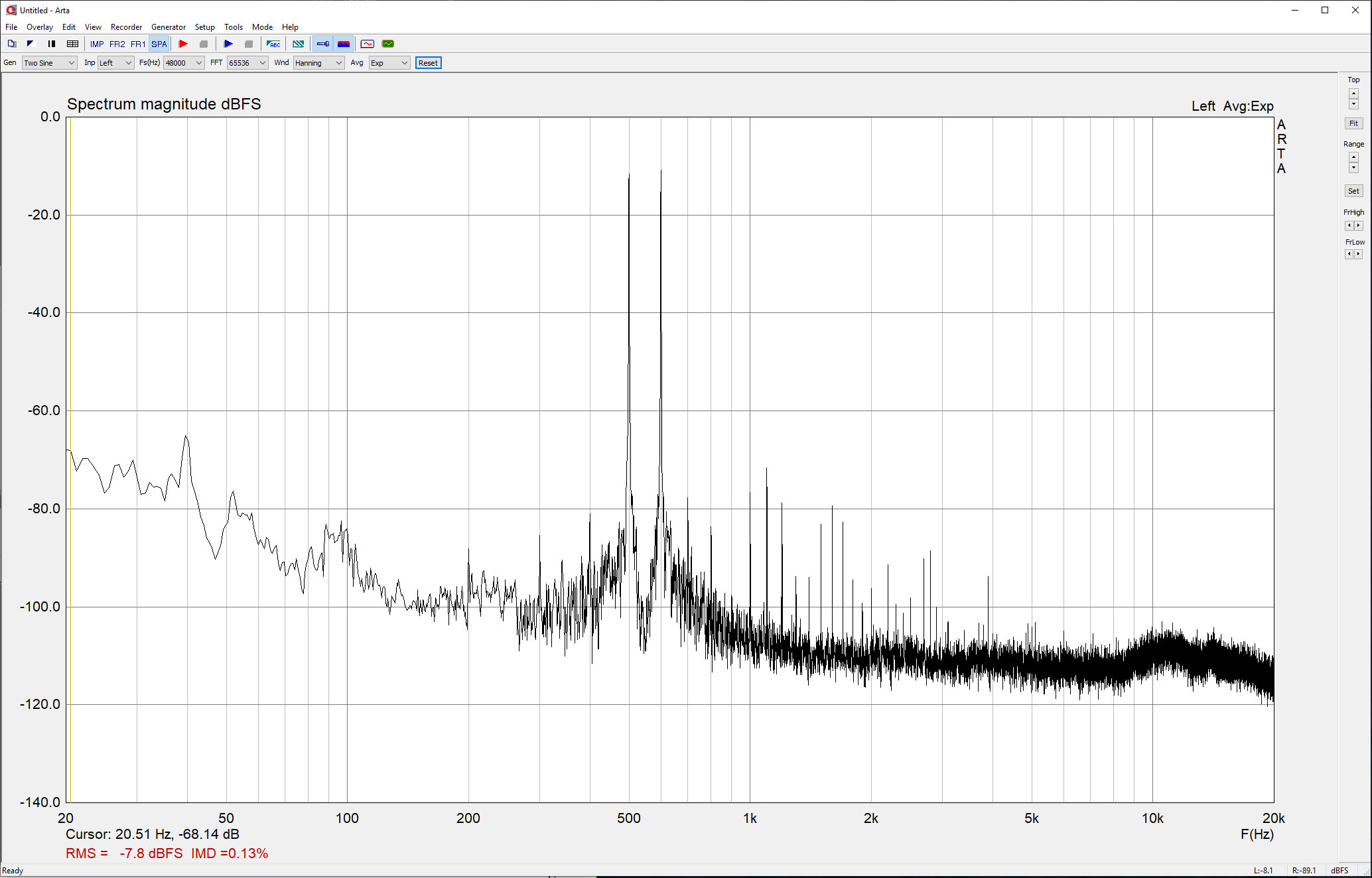

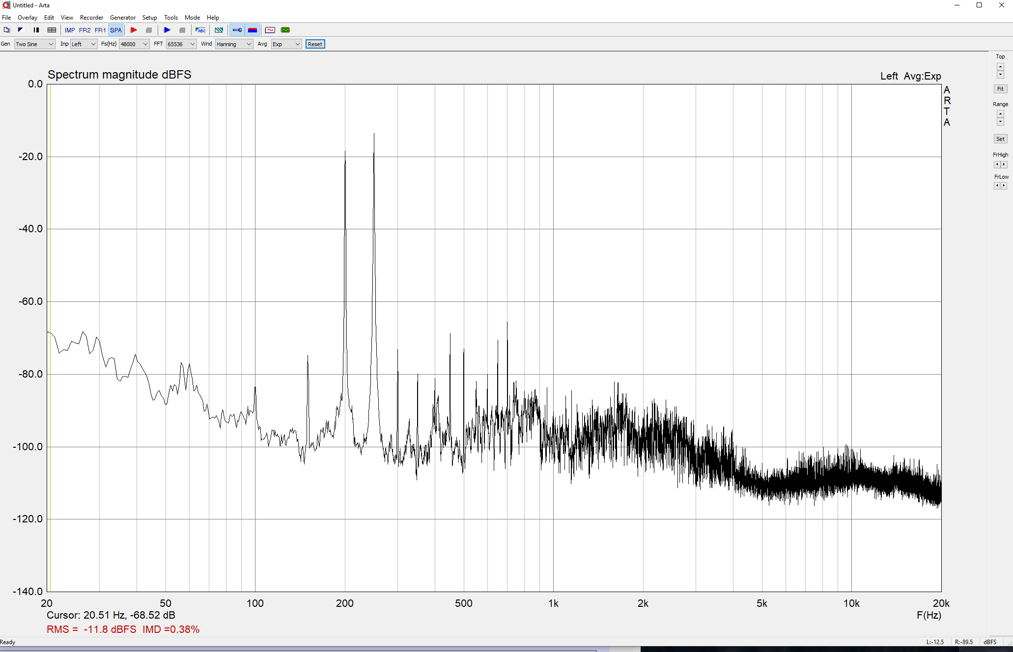

Here are PMA's measurements of intermodulation at 200+250Hz:

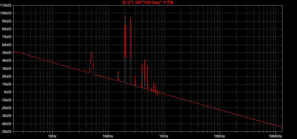

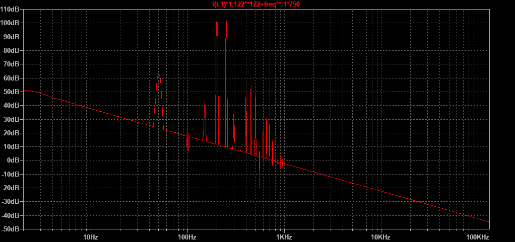

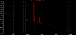

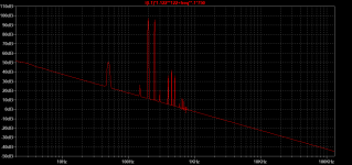

I rebuilt my speaker model to be slightly more modular but missing some features. I finally figured out a way to parameterize the reluctance force without affecting anything else. Attached are similar plots to PMA's measurements.
The majority of the distortion in PMA's plots appears to come from reluctance force and is 2nd harmonics. The 3rd harmonics aren't explained by reluctance force and for them I used very basic BL(x) modeling. These are only 2 distortions included in the model to get this result.

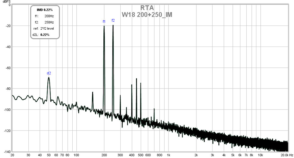

Interesting. For comparison, IMD measurements of a new speaker design I am about to finish. Measured in noisy environment, going to book anechoic room shortly for fine tuning and proper measurements. So far, so good.

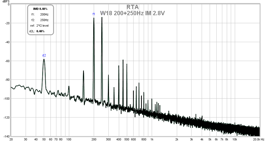

Looks like very good approximation, I think you speak about the attached measurements:
measured up close to driver? What about normal power level which would be used for same spl at 3-4 meters away in listening room (10W or more)? Every speaker can look better when speaker has very little power into it.
-RNM
-RNM
No anechoic chamber at my place. Measurement of distortion in a farfield in a room is a nonsense, as was many times explained. So please stop repeating your request.
