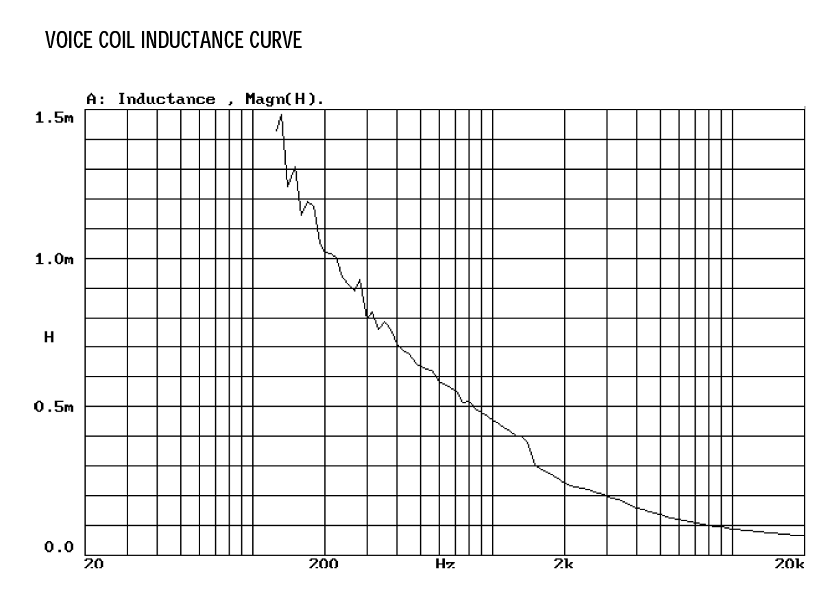

This might be interesting. The plot shows how voice coil inductance of the small woofer depends on frequency.
Several things conspire to do that.
1. shorted turns. Either a shorting ring in the structure, or a full aluminum vc former.
2. Eddy exclusion of the vc flux lines from the conductive pole tip and front plate.

I know not the mechanism, but almost all parts that specify inductance do so @ 1 kHz and also 10 kHz . Sort of ruins any semblance of a pure measure , as in Ohms, or Farads ......... Obviously cannot plot a L.R. response curve without first having a L.F. curve of the D.U.T........Several things conspire to do that. 1. shorted turns. Either a shorting ring in the structure, or a full aluminum vc former. 2. Eddy exclusion of the vc flux lines from the conductive pole tip and front plate. jn
For all the coils, inductors, and magnets I make or purchase, I have the tests done from 20 hz to 10 or 20Khz for the first articles. That picks up shorted turns, shorted laminations, or any hardware that happens to form a shorting loop around any laminations.
So I see a lot of inductor roll off. Some at 100 hz, some 2khz, my air core litz made 50 kHz. 360 pieces in two sizes. Had the vendors do 5 frequencies as a QA screen, we never received a bad unit.
Jn

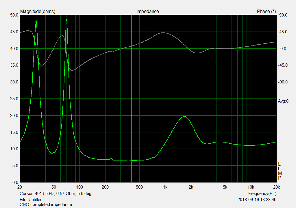

So how about measuring 3kHz and up and on-axis with the tweeter ?. The impedance graph does not show expected impedance rise, this is why I have asked twice for loudspeaker schematic please.I have shown 40 - 300Hz, however I measured 20Hz - 20kHz. Though the plots are not nice above woofer cone critical frequency and due to crossover frequency and phase interactions between woofer and tweeter, distortion is same for the speaker with and without "impedance flattening" in the whole range 20Hz - 20kHz.
Ok, but we are back to 'ideal' and 'perfect' conditions.....who has real world zero impedance cables and real world zero output resistance/infinite DF amplifier ?. Pavel I think it would be useful to repeat your test and measurement with an 'ok' quality stereo amplifier or better still a typical AV receiver. I have stated that I have 75R across each end of my speaker cables and that one resistor failed O/C was audible because of shift in channel balance and noise/graininess on the offending channel. Perhaps the perceived improvements of 'impedance flattening are due to attenuation of RF pickup and consequent audible secondary effects ?. Pavel, your work is good but not telling the whole story for real world. Dan.This procedure of impedance flattening is the dead horse in case that a standard solid state amplifier with voltage output and very low output impedance is used and of course capable to drive the complex load.
Yes, that test has actually been done. It was very long time ago... 1980's. Using SoundTech analog distortion analyzer. Which led to My investigating this and the adding of the Rs in series with the speaker and its voltage drop summed with amp neg input.Do you have test results that correlate to that? THD at each end of an 18 zip?
