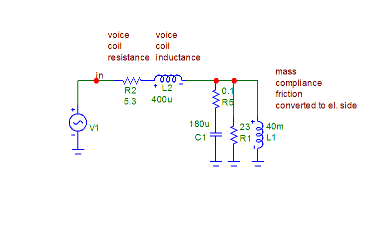

perfect voltage amplifier is already shunting with zero ohm impedance, how can additional shunt resistance do anything?

here in lies the assumption that causes the problem and why one cant figure out how the R works. Look at the buffering of the series Z of the interconnect between the amp and loudspeaker. If you connect - lets make it exaggerated - 20 foot pile of #18 zip cord to a dynamic speaker while you attempt to measure the THD ---- While the test is made at the amps output terminals, you get a steady number. At the other end... at the speaker terminals you get higher and erratic numbers. ... the effect of the back EMF at play. The worst case is at low freqs (around resonance of the speaker system). If you listen near field and with very short amp leads to speaker, all is close to your perfect/Ideal condition. Same results at either point tested. The "short" is only at the speaker terminals of the amp. The greater the series Z between dynamic driver and amp, the greater the parasitic effects. You really do need low series R as well as low series Ls in a speaker cable.perfect voltage amplifier is already shunting with zero ohm impedance, how can additional shunt resistance do anything?

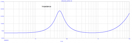

Attached is an electrical equivalent speaker circuit. It is simplified, but valid for explanation. R2 and L2 are voice coil resistance and inductance. However, they do not make the resonance!!. Resonance is mechanical and is created by mass and compliance, this transfers to electric diagram as L1 and C1. This C1 and L1 make the resonance, damped by R1 and R2+L2. Now, you want to add a damping resistor to point IN, across V1. What do you get? Nothing! You may short IN to GND but R2 voice coil resistance and L2 voice coil inductance still remains. Moreover, IN is already shunted by V1. You have no access to damp the R1//C1//L1 resonance.
