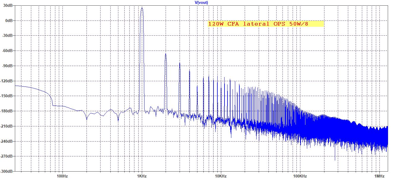

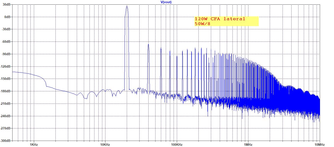

IMO, it does not make any sense to fight below 0.01% of H2 and H3 in the power amplifier. It is only a race for prestige, then, not for a better sound. On the other hand, it makes sense to keep higher order harmonics as low as possible.
This should be good enough.😀
If the real amp can get close to the simulation.

OK, when I say EAR I mean the whole chain plus brains evaluation. Sorry I do not mean to go nit-picking in the discussion. I hate useless, nit-picking discussions without any additional value.
Yes it should be good enough IMO, if there is not another issue and if the real world fits to simulated values.
